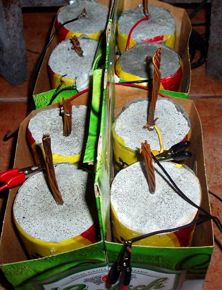

    I do get an Ac reading out of my 1 1/2 year old cement cells, pictured below, that are in a bank of 4 cells, giving 8volts Ac., and 4 volts Dc. with no load on them. As these cells are very dry now they only output 300uA. (originally 50mA each cell), but if I let them soak in water overnight current levels go back up. They have been running an oscillator but can also light leds direct. These are the lowest maintanance cells that I've made.
    Recent cells only put out about 1.0 volts Ac, and 0. 8 v Dc. from EACH carbon/Al cell, but up to 60mA, when new.
    This is a correction and edit to this same post which I placed yesterday.
    The fact that a cell(s) can light an led with only 200uAs is something to look into.
    My analog meter will usually show an AC reading that is twice what the DC reading is on the same battery. But, it will not show anything on the AC setting if the polarity is reversed.
