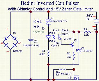

    JB
    ok here are 2 more Sch's, they should both be correct now......
    I just knew that the first Sch i posted was not biased correctly, but was not sure what it needed to correct it. and it looks like my 2nd guess was not correct eather...
    Thanks RI2003, these Revisions to get it correct, should help everybody.
    using lower V sidactor triggers, and opto Darlington Mosfet/transistor Pulsers, in Joule Thief and Joule Ringer applications, will make low V pulse charger apps easier to implement too.
    Thanks again,
    RS

    RS,
    Sketch #2 with the Zener, Move that 2.2k off the negative of the battery and put it to the plus of the battery and it will work. You can not have anything to the negative pole of the battery with this switch except for the FET.
    John B
    Leave a comment:
  • RS_
    replied
    JB,
    Here are 2 Sch's, One with the Zener and 2.2K resistor as i think you've described, and another with the Regulator input hook to the neg side of the charge battery and the adjust hooked to the capture cap neg, as i asked about in the first post. And back to using the sidactor to trigger the opto, as I misunderstood that in your first edit.....
    Hope I got them both correct this time.............
    RS
