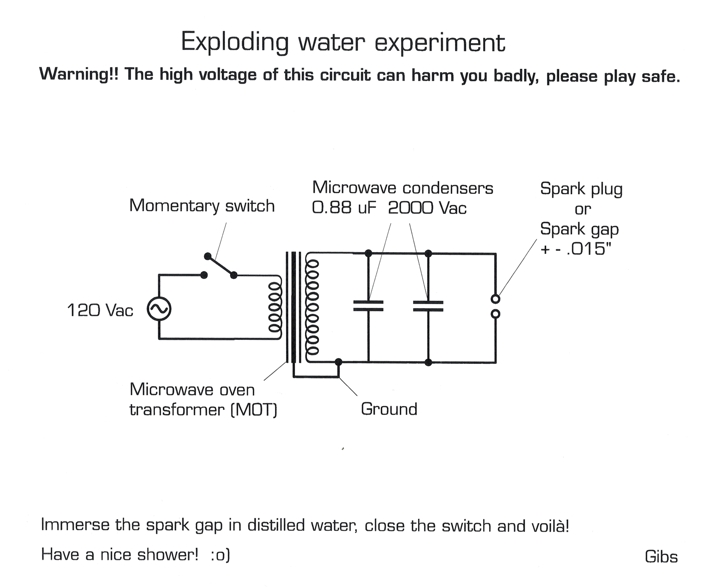

and
my ears... man... is that loud or what
. My girlfriend came running to the room, thinking I would be dead with that kind of blast.
