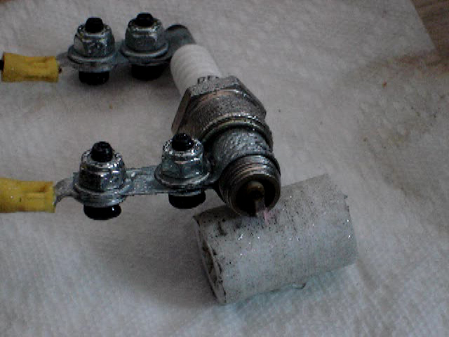

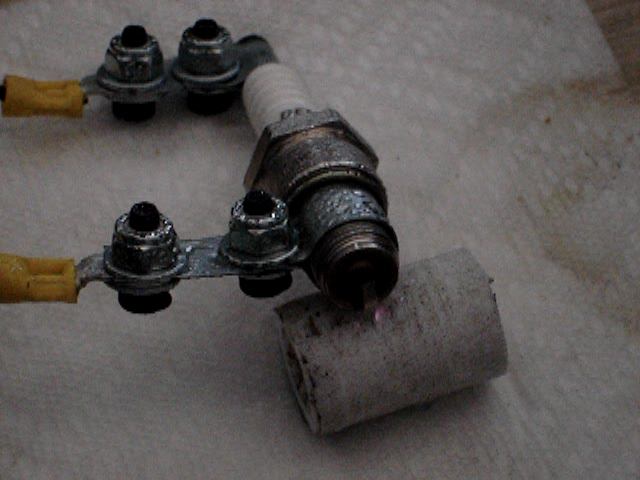

Sometimes you see the effect and sometimes you don't, it is because you don't fire your relay in synch of the 60Hz wall current frequency. Sometimes you hit the right spot and sometimes you don't

so how can that be affected it?
