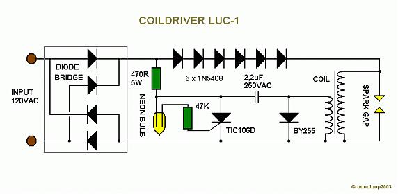

If I understand well, it means that my 2 uF cap (approximately) would fully discharge in about 50 us. So if my calculations are right, at 3600 rpm there's 60 firing per second on a two stroke engine, so 50 us multiplied by 60 would give 3000 us firing time per second or .003 second.
So one second minus .003 = .997 second per second left to recharge the cap.
Divided by 60 events per second = 0.0166 second maximum per recharge...
Before going further, does it seem right for you?
