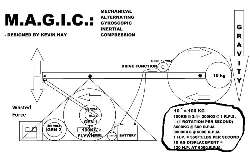

    I have to agree with you that Ron did not build this device exactly as Mr. Hay has drawn it.
    Hey Citfta, thanks.
    I also agree that moving the pivot point to the left will give more force on the left end of the moving beam. But we need to look at a lot more than that.
    If we move the pivot to the left we not only get more force on the end of the moving beam but we also reduce the amount of travel on that end of the beam. So while we have more force we have less travel to make use of.
    Well, having a 50/50 split or a 1:1 Ratio...according to math, it is an even force exchange, no increase force.
    And, yes, I agree that by extending the weight side we will have less travel distance, but MUCH more force, which could be utilized according our displacement.
    Like I have cited before as a real comparison with this, is an ICE (Internal Combustion Engine) and basically the Counterweights versus Piston movements...all very compact and nicely aligned to make a sync rotation of engine main shaft (crankshaft) without any "blank spots" missing in the Blue Print Designs... correct?
    Also as I have marked in the drawing the way Mr. Hay has shown the moving beam connected to his generator will waste a lot of the force since the connecting arm is connected to the beam at such a shallow angle. Almost all the downward force is only moving the connecting arm sideways and not contributing to the turning of the generator. This also reduces the amount of movement at the end of the arm. In Ron's build he tried to correct that problem by putting the force of the moving beam straight down to the flywheel and then to the one-way bearings when the flywheel idea proved unworkable.
    Kevin has a pretty lousy video on YT (which he shows link to Ron's Video on his comments), where he shows a pretty simple bike wheel which is being rotated by a very small motor as also a lousy small wheel attached to it...however, turning into a force which is so strong it can not be stopped by hand as he does stops the small motor...the video is very poor, the model is shaky and made out of wood... without even a base to stand firmly on floor...but still, we ALL could see what he means by doing it...
    You mentioned a timing problem with this device. I am not sure what you mean with that statement. The device is self timing. As the weight of the off balance wheel moves up and down the moving beam also moves up and down in time with the weight movement. You can see that in Ron's video. If you see some way to do that differently then please explain what you meant.

    Hey UFO,
    I have to agree with you that Ron did not build this device exactly as Mr. Hay has drawn it. I also agree that moving the pivot point to the left will give more force on the left end of the moving beam. But we need to look at a lot more than that.
    I have also circled in the attached drawing in the lower right corner the claims about the power out. I find those rather hard to believe. The only way the output generator could turn at 6000 rpm is if the moving beam was moving up and down 6000 times per minute. That would mean the beam would be moving up and down 100 times per second. I don't believe the beam could possibly move that fast.
    I also don't understand where the 10 squared = 100 kilograms came from. What formula did he use to get to the 10 squared?
    My final problem with this device is the reaction Mr. Hay had to the video. I have been in contact with Ron before the video was shared with Mr. Hay. Ron built this device in good faith hoping to see some good results. The video was not made public in order to give Mr. Hay a chance to see it and make some suggestions as to how it could be better made to more closely get the results he claimed. Instead of constructive criticism, Ron got bashed.
    I would like to see Mr. Hay come to this forum and show us a working device that can do what he claims is possible. Maybe there are some things Ron could do to make it better. But we won't know that until Mr. Hay stops bashing Ron and actually gives some helpful information. I invite him to do that here and not on Facebook. There are many of us that refuse to go to Facebook to look at things.

    First I will show Three (3) Kevin Schematics:
    1-
    On above image it is clearly shown the DIFFERENT RATIO OF LEVER VERSUS FULCRUM POINT DIFFERENCES...
    HOWEVER, in ALL We can see that the Weight-Wheel SIDE, WHERE ARM IS BUT, WAY LONGER IN ALL DESIGNS.
    Kevin calls this AXIS POINTS as He shows on bottom image a 5:1 RATIO
    2-Second Kevin Image:
    Note this one above is a Three(3) to One(1) Ratio...
    3- And finally, here is a MUCH MORE SIMPLIFIED GRAPHIC:
    And now, here is the best image I could get -from your video- of a SIDE ELEVATION of your Machine...
    Now, to be fair, I would say that you have -approximately- a "50:50" (1:1) ARM-PIVOT POINT RATIO (Just like a "Teeter-Toter or See-Saw for Kids to balance on both sides EQUALLY)...But, the best that you could do is to provide Us here with a CAD, showing the right Elevation Side Profile of your Machine, just like ALL Kevin's Designs above...
    NOW ABOUT WEIGHTS DISTRIBUTION...
    And so, If You have noticed, in ALL Kevin's Graphics, He has the Motor and small wheel, rotating the bigger wheel and weight...ON THE OPPOSITE SIDE TO WHERE YOU HAVE IT....and almost SIDE TO SIDE to the big wheel.
    Kevin's disposition ADDS EVEN MORE Weight to the LONGER ARM SIDE by aligning Motor on the longer and extreme side of the Arm...this fact, OBVIOUSLY ADDS more weight to that side, therefore more Impact Force on opposite side.
    And, Your Nice Machine have it on the EXECUTING SIDE OF THE ARM...
