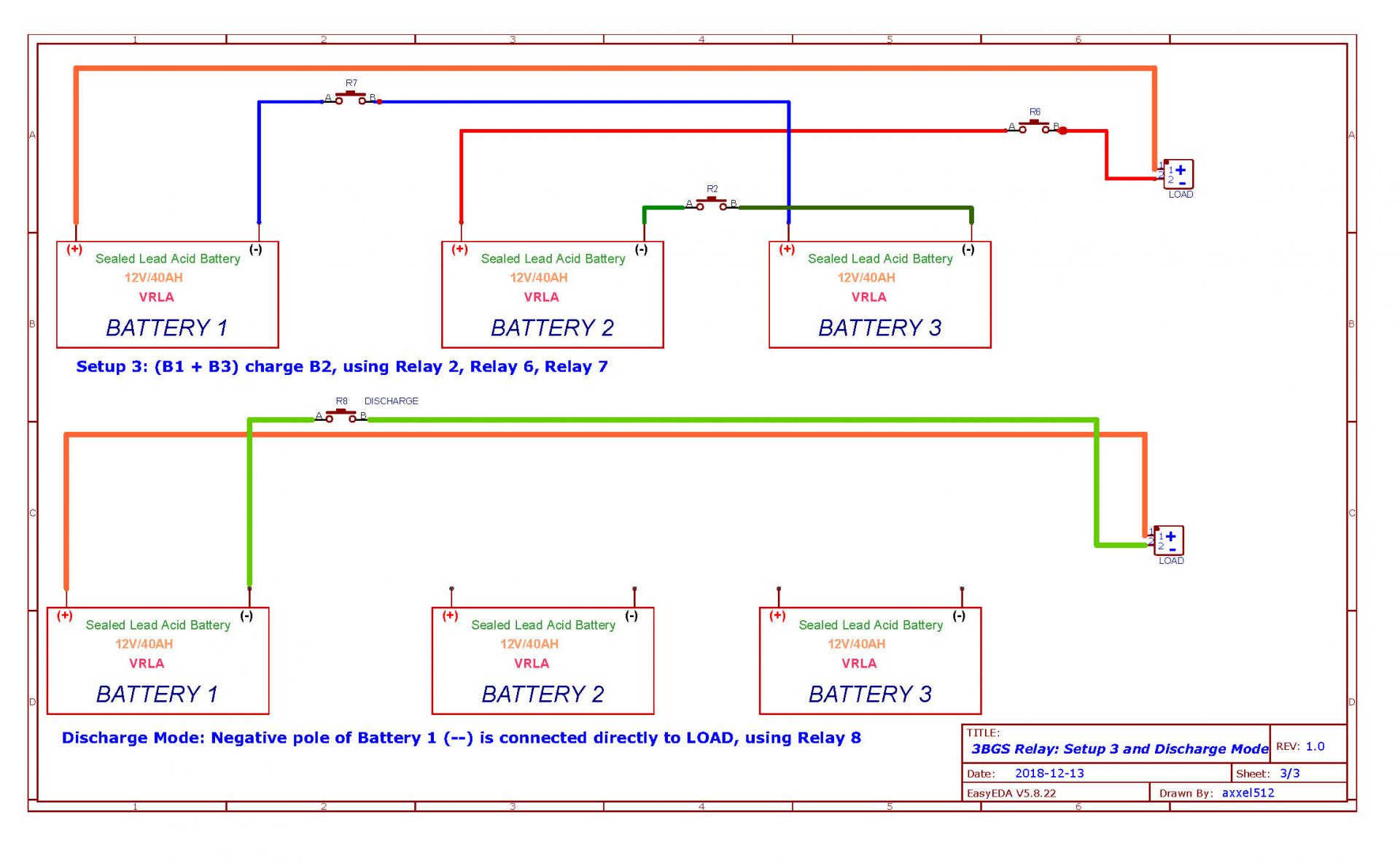

    1. because I use a 8 relay module (12 volt, this time), the current draw is bigger (@200 mA - 20 mA for Arduino nano + 150-160 mA for 3 relays ON);
    Note: after Alex post, I decided to give a try to his suggestion: VOM1271T Photovoltaic MOSFET Driver, for switching with Mosfet all connections. What do you think?
    2. In one configuration (Battery 2+ Battery 3 are charging Battery 1 - Setup 2, page 2 from files attached), the polarity of the load is reversed, which can be a BIG issue sometimes. I figure out how to solve this, but I need 3 more relays, and this time any switching mode have 4 relays ON, which means MORE current draw from the 4-th battery (which is powering my Arduino).
    3. For automatic switching, I need for each battery a voltage reading, through a resistor divider. For all 3 voltage readings to be send to Arduino, though, they need to share a common ground, which, again, it's a problem. This can be, eventually, solved with optocouplers like 817 or so.
    You mention: „I have many Fet controlled 3 battery switchers that run from an arduino”. How did you managed to solve the common ground issue, for both voltage readings and for switching connections?

    I tried to use only n-Mosfet on the low side, but didn't figure how to isolate mosfets from common ground issue, since each need 5 volt, so all mosfets are sharing same ground, which is BAD for switching all connections from those 2 batteries....With relays it is working quite nicely, though the code should be improved. This setup was easy to made, though, since both batteries shared the same ground (common -), in the first place for voltage reading side of Arduino (with voltage divisors), and then for setting the relays.
    After some running tests with modified motor in 3 BGS configuration, I was very excited by the results, I decided to go BIG, and to make the 3BGS automatic switcher.
    First step was to make an semiautomatic switcher, based on 4 push-buttons + Arduino and relays, so I can select manually what charging configuration I need. See the PDF attached to this post, you will understand better. This configuration works, BUT, there are, also, some issues.

    I have not followed all your questions. If you summarize for me what you are looking for I probably have a schematic for it, with part numbers. From what I have read you need DC/DC ssr's. They can get expensive but at low power they can do a lot. If you looking for high power Fets are the way to go and I have many Fet controlled 3 battery switchers that run from an arduino. Just outline what you are looking for and the next time I check in I'll try to help you out.
    Hy, Matt, thank you for your reply. I'm trying to do an automatic 3BGS switcher using Arduino.
    My previous attempt was to make something similar, but only with 2 Batteries and an boost-converter. I managed to make this switcher, but only with a 4 relay module (5 volt).

    Hy, Alex, thank you for your reply, It looks like this chip is perfect for me.
    I will soon order some drivers, to test in 2BGS setup first. Right now, the Arduino + Relays are drawing way too much for my switcher (- 200mA/hour) which is draining very fast the extra (Arduino) battery.
