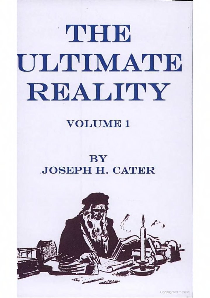

Peter Daysh Davey Water Heater Query
  • RAMSET
    replied
    very nice
    looks like I'll be Calling more than One Old Friend.
    thx for the smile
    Chet
    Leave a comment:
  • daemonbart
    replied
    Hello!
    Nice to see some action here!
    Still working on my understanding of this.. anyway i hop to crack the code soon. Many setups to run.
    Thanks D
    Leave a comment:
  • RAMSET
    replied
    Paul
    Professor Savic had either sent a link To David or posted it in the Sonic boiler thread ?
    but I do remember seeing it, and comments were made that this patent was in Libraries over _There_ but no longer over here???
    It would be nice to speak with David again[slovenia]
    I'll ring him before our turkey holiday.
    thx
    Chet
    Leave a comment:
  • wrtner
    replied
    Paul
    the Savic device was based on a Tesla resonant water tube heater as I recall.
    the beer can was merely an attempt by a very smart fellow with No resources to investigate within his budget ,and perhaps pass some time too...
    and to be clear a harmonic is a harmonic ..but quite true the closer you get to the Main frequency the less fussy the tune becomes.
    repost of Bob's link
    https://www.youtube.com/watch?featur...hlTTMo#t=15 4
    Thx
    Chet
    Dear Chet,
    Interesting. What Tesla water heater? Which of his patents?
    I can't remember about Savic but Davey is not about harmonics; he is about octaves.
    Leave a comment:
  • RAMSET
    replied
    Paul
    the Savic device was based on a Tesla resonant water tube heater as I recall.
    the beer can was merely an attempt by a very smart fellow with No resources to investigate within his budget ,and perhaps pass some time too...
    and to be clear a harmonic is a harmonic ..but quite true the closer you get to the Main frequency the less fussy the tune becomes.
    repost of Bob's link
    https://www.youtube.com/watch?featur...hlTTMo#t=15 4
    Thx
    Chet
    Leave a comment:
  • sprocket
    replied
    Originally posted by Bob Smith View Post
    The Dumas Effect strikes me as quite similar to the one being discussed. Maybe it's the same idea. Dumas himself made everything open-source, and it seems people in France are using it to heat their homes with a 116%COP. Here's a video that I've cued up to where Dumas himself speaks. It's in French with Eng subtitles; lots more in French as well:
    Bob
    Damn, wish I'd seen this video before now! I expended much effort a few years ago on the Davey heater only to end up with an expensive and very dangerous way of boiling water. This seems much more promising, maybe I'll give it another go. Thanks for posting this.
    Leave a comment:
  • wrtner
    replied
    Bob
    yes the "tune" is Key ,the Savic Sonic boiler thread was all about that "tune".
    we never got the crazy high Cop's claimed By Professor Savic.[TUNE ????]
    What Savic does not seem to understand is that one cannot simply tune anything to any frequency. An item will have its natural frequency, and that is that. Cutting bits off his beer can will make the natural frequency go in the wrong direction, i.e. up.
    I cannot remember what frequency he was chasing. In the high double figures, I suspect. His beer can would need to be the size of a small dustbin.
    Dumas is interesting but nothing to do with Peter Daysh Davey.
    Leave a comment:
  • RAMSET
    replied
    Bob
    yes the "tune" is Key ,the Savic Sonic boiler thread was all about that "tune".
    we never got the crazy high Cop's claimed By Professor Savic.[TUNE ????]
    what you are describing [9V battery] sounds Like our Amish friends
    WITTS claim.
    and yes I do agree.
    thx
    Chet
    Leave a comment:
  • Bob Smith
    replied
    Bob
    Thanks for posting that ,The best we could get in USA [110V 60 HZ] was similar to this "DUMAS" claim COP 1,10-1.50
    HOWEVER, we needed Electrolyte to reach those COP's
    end to be honest ,it is not outside of "error window".
    HOWEVER<HOWEVER
    we have learned some things since those days about water.
    some new ideas to try [thx Johan 1955]
    looks like we'll be playing in the water with Mains voltage again .....
    drives some Peeps crazy .
    and yes "Paul" [and all] it is dangerous...
    thx
    Chet
    Chet,
    From what I see in Dumas' presentation, I'm inclined to believe the key to this whole thing (in the Dumas setup) is the golden mean, which dictates the gap between cathode and anode. And while mains voltage allegedly works in his system and is freely accessible, perhaps it isn't really necessary. I would not be surprised if someone were able to drive this system with an AA or 9V battery and simple AC producing circuit; perhaps even a 555 switch and square wave.
    Bob
    Leave a comment:
  • gyula
    replied
    Originally posted by greatwest1 View Post
    I tried the link for vol. # 1 and it was a dead end.
    Could someone re post it for me and perhaps others ?
    Many thanks, vol.2 is absolutely amazing !
    So much to learn .... Lol !
    Tx. Greg.
    Hi Greg,
    Volume 1 seems to be available (freely readable) only on scribd.com:
    Scribd is the world's largest social reading and publishing site.
    Gyula
    Leave a comment:
  • RAMSET
    replied
    Knock Knock David [Slovenia :'} ]
    Bob
    Thanks for posting that ,The best we could get in USA [110V 60 HZ] was similar to this "DUMAS" claim COP 1,10-1.50
    HOWEVER, we needed Electrolyte to reach those COP's
    end to be honest ,it is not outside of "error window".
    HOWEVER<HOWEVER
    we have learned some things since those days about water.
    some new ideas to try [thx Johan 1955]
    looks like we'll be playing in the water with Mains voltage again .....
    drives some Peeps crazy .
    and yes "Paul" [and all] it is dangerous...
    thx
    Chet
    Last edited by RAMSET; 11-22-2014, 07:31 PM.
    Leave a comment:
  • Bob Smith
    replied
    Dumas Effect
    The Dumas Effect strikes me as quite similar to the one being discussed. Maybe it's the same idea. Dumas himself made everything open-source, and it seems people in France are using it to heat their homes with a 116%COP. Here's a video that I've cued up to where Dumas himself speaks. It's in French with Eng subtitles; lots more in French as well:
    Bob
    Leave a comment:
  • wrtner
    replied
    Originally posted by greatwest1 View Post
    I tried the link for vol. # 1 and it was a dead end.
    Could someone re post it for me and perhaps others ?
    Many thanks, vol.2 is absolutely amazing !
    So much to learn .... Lol !
    Tx. Greg.
    Where is the post that you are quoting from? What page?
    Last edited by wrtner; 11-22-2014, 02:52 PM.
    Leave a comment:
  • greatwest1
    replied
    volume 1 - where is it ?
    Originally posted by Slovenia View Post
    Make sure you check out Vol #2 also. This guy, Joseph Cater, is incredible so you don't want to miss anything. He brings a lot of stuff to light that few other authors address. A lot of forgotten folks are brought up in his books.
    I tried the link for vol. # 1 and it was a dead end.
    Could someone re post it for me and perhaps others ?
    Many thanks, vol.2 is absolutely amazing !
    So much to learn .... Lol !
    Tx. Greg.
    Leave a comment:
  • wrtner
    replied
    Originally posted by Duncan View Post
    Soooo Bells have been cast for thousands of years ,obviously when used,, as they very often are, in sets the tones must match, therefore there is obviously a fundamental formula for casting and the all important proportions https://www.msu.edu/~carillon./batmbook/chapter5.htm
    An interesting link. Have you found a similar page on straightforward hemisherical bodies? Like woks.
    Leave a comment:
