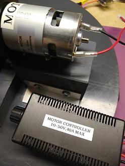

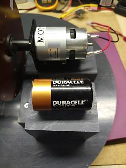

    The motor I'm using is a small 12/24V PMDC motor called a 775 size. Similar motors found on Amazon indicate a rating of 80 watts. With my accurate ammeter I can go up to 3 amperes, so 36 or 72 watts at 12 or 24 V.
    I use a PWM motor controller to adjust RPM and limit current as not to peg ammeter on acceleration.

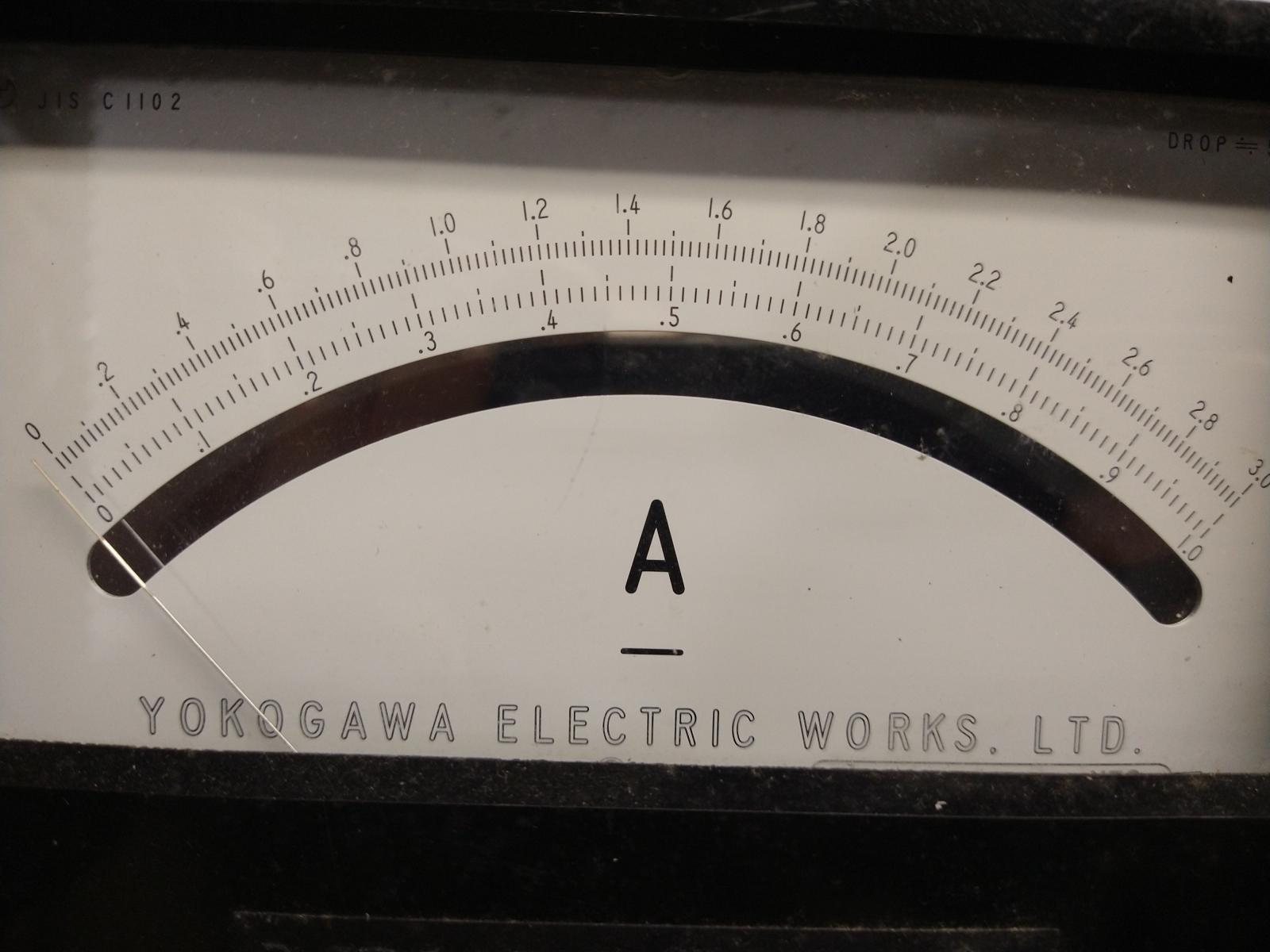

    I use a lab grade ammeter not a cheap eBay panel meter. It can indicate milliampere changes on scales from 100 to 3000 mA.

    So far, I've been running 4 magnets on the rotor. I intend to change to 12, maybe today. I have tested using one and two cores. I made provisions to use 3 cores with 3 opposition magnets if I want to go that far, with 12 rotor magnets.
