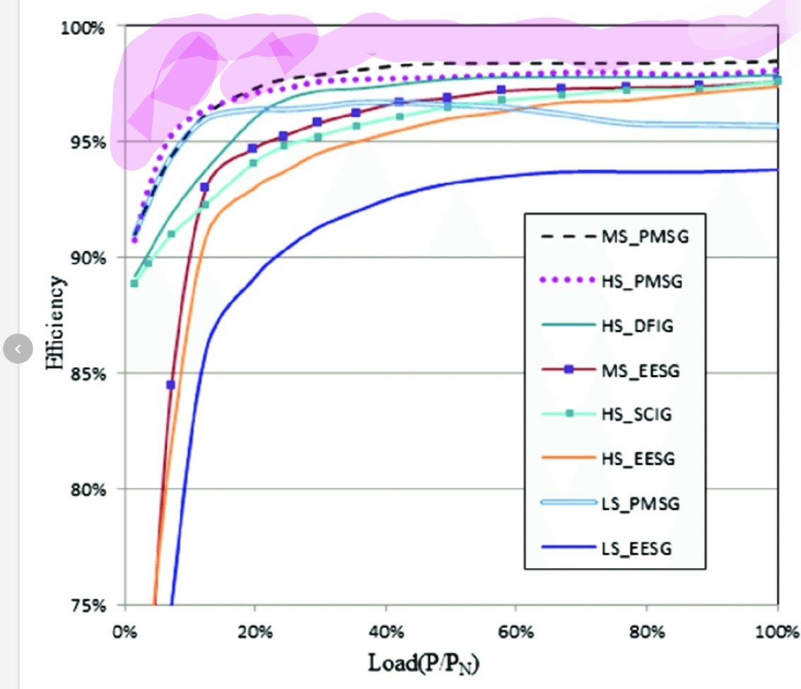

    Here's an idea about the brutal facts. Click image for larger version  Name:	Screenshot_20210331-210744_Chrome~3.jpg Views:	0 Size:	118.2 KB ID:	505228
    I've tried to colour in purple the area you must be in to achieve enhanced generator performance.
    You will see electrically excited gen. comes out the worst of the bunch. That's a definite no for the small electromagnets.
    If you want to prove acceleration under load you've got to do it in the purple, otherwise you're just altering the efficiency of the system.
    The easy winner is the medium speed permanent magnet synchronous generator, that's the one you've got to beat!

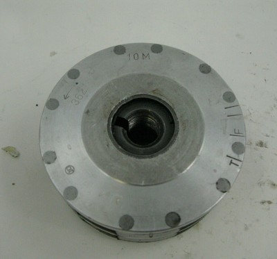

    To reach a 2-5 thousandths tolerance a person could use a 3D printer or a light duty CNC router milling table for cheap non metal plastics.
    If it is a rotor as a magneto you could make it like this. Almost anything works. Don't ask Dave he sends all of his high tolerance work out to his machinist. Out of sight out of mind but the need for accuracy is real. It's not that big a deal? Really. Tell that to Greyland.
    https://i.ebayimg.com/images/g/9W4AA...EMX/s-l400.jpg
