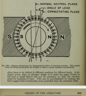

  • bistander
    Mr bistander. If you look at the currents in the armature conductors, the magnetic field in the ring core is obviously not the same as in the picture. The polarisation of the core from the outer poles of the stator cannot be as in the picture either. Take and carry out modelling in the appropriate program, is it difficult in the 21st century.
    Hi Rakarskiy,
    The representation depicted in figure 289 does coincide with the author's description of the portion of the armature field which bucks or opposes the main field due to currents in conductors 34-36 and 16-18 when the commutating plane is rotated from the natural neutral plane as shown. Read on page 269.
    "The current in inductors 1 to 15 and 19 to 33, tends to cross magnetize the magnetic field of the machine, but the current in inductors 34 to 36 and 16 to 18 tends to produce north and south poles as indicated."
    I, unfortunately, have not the means to produce FEMM. But if you do, please post. Thanks for the discussion.

    So I've been continuing to study the Hawkins Electrical Guide and this diagram in particular.
    Figure 289.
    It depicts a dynamo as a generator under load. One can confirm generator mode by the direction of rotation indicated by the author, the polarity of the main field and directions of current in the armature conductors. The purpose is to aid in the author's explanation of field weakening when the commutation plane is shifted away from the neutral plane.
    When you read carefully, you will understand that the smaller N and S labels in the circle representing the armature only apply to the field attributable to conductors 34-36 and 16-18, which buck the main field. The remaining armature currents produce the typical armature field direction at quadrature to the main field.

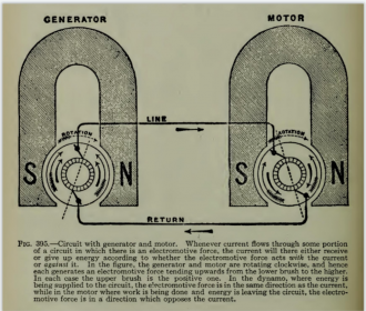

    As I continue to follow that Lockridge thread, I am pleased to see the reference to this text:
    It does teach correctly basic aspects of electric machinery, with only a few mistakes noticed.
    This lesson:
    I like. It shows plainly and reinforces my claim motors and generators are the same.
    A mistake, which I mentioned, concerns the cause of the shift of the neutral plane. It can be seen in the diagram that everything is the same between the generator and the motor except for the direction of armature current and the neutral plane shift. And it is this armature current which is the cause of the neutral plane shift, not rotation. In another section of his text, the author claims rotation of the armature causes this neutral plane shift. That shift is due to armature field distortion caused by current, and nothing about rotation. The diagram above shows this.
    In another chapter he discusses armature winding and covers multiplex. A rather obscure feature that I mentioned recently. A feature which was incorrectly defined numerous places simply relying on Google search. These old textbooks are great resources.

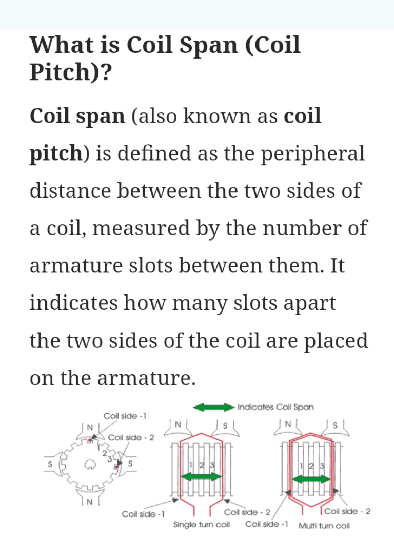

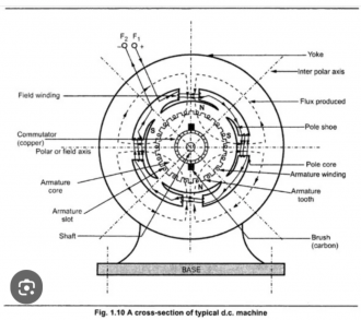

  • bistander
    Hi all,
    I've been following another forum, OUM, thread about Lockridge device. Ufopolitics is designing his version. I have not analyzed the original device but have been following Ufo's explanations on his approach. I'll just list some comments below for those interested.
    .... Nomenclature, what to call what. Helpful to use standard jargon of the field. Such as found here:
    Click image for larger version  Name:	Screenshot_20241127-000532_copy_1024x909.png Views:	0 Size:	430.6 KB ID:	515484
    ​​ ​​​​​From:
    ​​​​https://eeebooks4u.wordpress.com/202...-a-dc-machine/
    Also concerning armature windings:
    Read the article here:
    https://www.electrical4u.com/armatur...mutator-pitch/
    The idea to reduce the coil pitch without altering some other items will produce unintended consequences.
