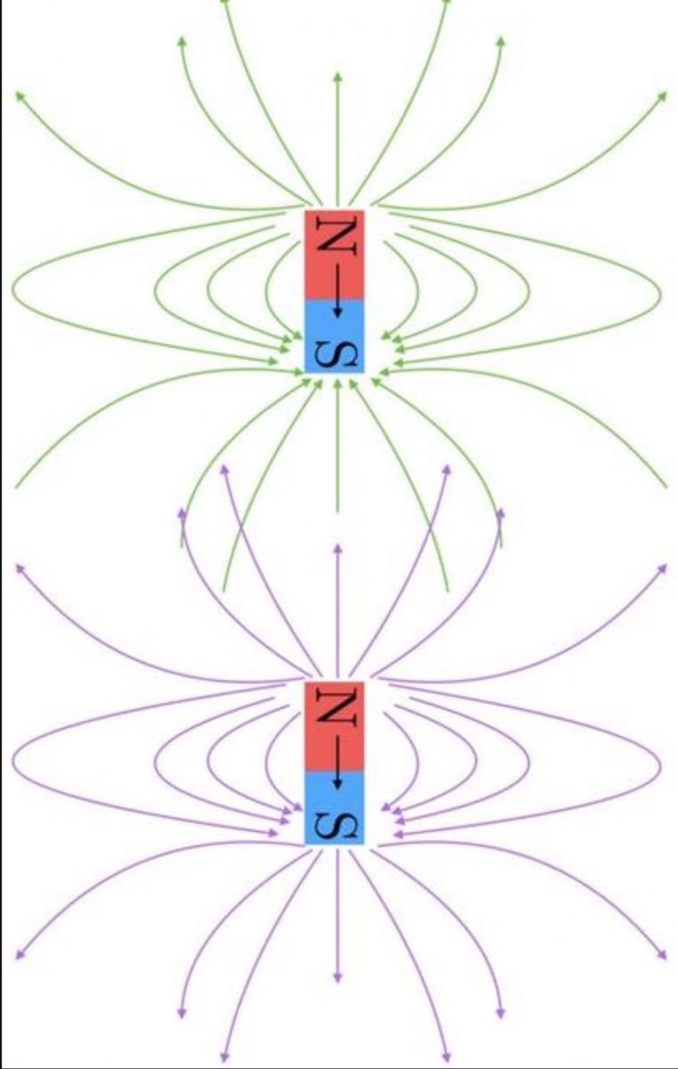

    About the test
    Bistander.
    I don't know why you have complicated so much this so simple tests!!
    First off, it seems your iron is retaining magnetism too much...NOT Good., so discard it and user one that does not retain enough for compass to even move when in front of it.
    If Iron retains magnetism, when you flip it it will retain an opposite pole from previous facing opposite magnet pole...this throws off test.
    And of course I MUST keep at least either Iron or Magnet FIXED during tests, otherwise they both will fly together!!
    HERE IS A VERY SIMPLE TEST, WHERE MAGNET AND IRON ARE FIXED, YOU JUST MOVE COMPASS:
    [IMG][/IMG]
    , like supposedly happens in test at right, IF there would be an opposite pole on Iron, right next to Magnet's South Pole.
    Compass behaves just like Test on Left, and depending on Iron size, and Magnet Strength needle could deflect more towards center space between both Iron and Magnet.
    Keep it simple...and please, do not mark the iron...it confuses even more.
    Ufopolitics
    Leave a comment:
  • Ufopolitics
    replied
    Bistander.
    [IMG][/IMG]
    Ufopolitics

    Magnet Induction Test
    Hi Ufo,
    Here's my test from yesterday.
    test 1: Red tape on magnet S pole. This does not change through test. Red tape on one end of iron bar. The red tape remains on this end of the bar throughout the tests however the N and S will change ends later. For now the magnet induces a field in the iron bar so that the red tape is on the S pole. Compass has a red colored arrow end which is N seeking so is a S pole. Therefore the white end of the compass needle is a N pole. Compass needle colors and poles remain the same throughout the tests.
    Tests are conducted on a non magnetic table top in a East West orientation to minimize natural fields.
    test 2: Compass re-positioned between magnet and iron bar. Red end of iron bar remains S pole.
    test 4: Magnet is removed from test. Red end of iron bar remains S pole.
    test 5: Magnet is returned to the test in opposite orientation from test 1. The induced field in the iron bar is now reversed and the red end is now a N pole. Magnet needle remains same color/polarity but the red arrow (S) now points towards the iron bar red end (N). The induction in the iron bar has reversed due to the magnet being reversed in orientation.
    test 6: Magnet removed from test. Iron bar reverts back to previous polarity because it had been more strongly magnetized in that direction (it actually had touched the magnet in the previous orientation). The iron bar red end is S and attracts compass white (N) needle end.
    To me, these test are consistent with domain and dipole theory. Magnets always have 2 poles which we call N and S.
    In these tests I have a very strong permanent (N42) and the iron bar is a piece of 1/4 inch square key stock probably really cold rolled steel. The iron bar is easily magnetized by induction from the magnet and had medium residual or retentivity. The magnet's field is stronger than that which it can induce into the iron bar. And the field of the compass needle is weak but retentivity is high. It is not permanently affected by the fields from the magnet.
    As Ufo posted his test I could not help but think: The compass needle is behaving the same as the iron piece except his iron piece is not allowed to rotate. But the induced field from the magnet and/or iron piece is inducing a field in and on the compass needle causing the compass needle dipole to rotate, the same as it would on any ferromagnetic piece in the field. He appears to attempt to use the very behavior which he is testing to disprove that behavior.
    I'll believe the experts, text books and lessons from history that all magnets, PM, EM or induced, have 2 poles.
    Thank you,
