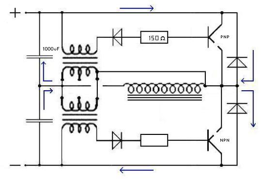

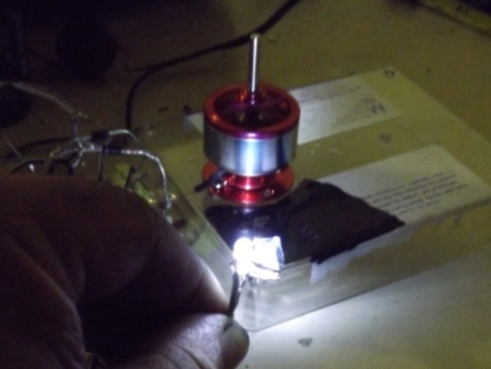

    you will see what i mean when you unwrap one.the emax motor i got has 12 stator poles and 14 neo's in the hub.imho the only way to achieve perfect timing,max efficiency with that pole combination is to treat it as a six phase motor.there is no way powering 2 phases at once,as with a standard controller, can possibly provide the optimum timing to every energized stator coil at any point in time.also delta wound 3 ph motors are known to generate cross currents that produce heat and reduce efficiency.there has to be counterforces in the standard setup.maybe,just maybe these motors are dumbed down a bit to conceal their true potential.
    using mini isolation transformers that sense off the same coils being driven,this circuit works well.to have 6 phases like this 30 degrees apart would require 12 mini iso trafos and 12 transistors,as well as double the battery voltage.maybe too much weight for a flying model plane,but no problem on a bench.finding the right wire diameter and turns may take some trial and error,but this will give near perfect timing to every stator coil opposing pair, each of which will be on a bit over 90% of the time,(timing and duration are variable to a point with added components).which should make for a very efficient and seriously grunty little motor.other motors can have different pole counts, which could well call for a different phasing strategy.
    cheers.
