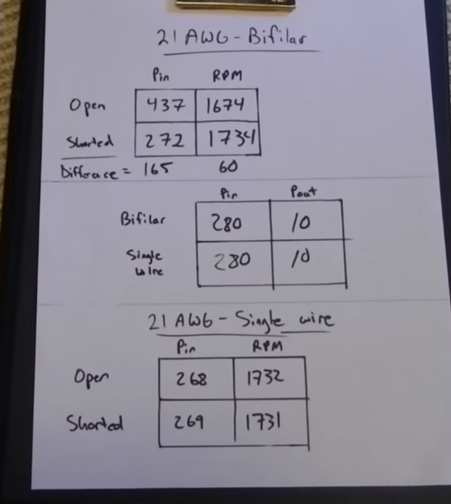

                Turion,
                Look at the resulting data from the debunker.
                Resized pictures - 1 ​​​​​
                It is obvious that, compared to the monofilar coil, the bifilar coil caused 169 watts additional to a single core and coil. That is quite high, say compared to 300 watts claimed system input under load. That 169 watts is all converted to heat in the coil assembly. Because the 169 watts is not present under exact same condition using same core with the monofilar coil, that 169 watts is logically coming from the bifilar coil.
                Question: how much does the core loss (how many watts) contribute to your heating issue? If you were able to totally eliminate core loss, would you still overheat the coil core assembly?
                Under load, the coil loss (I2R) is easy to figure. But I get the impression that it heats up before load is applied. Can you enlighten us as to how you know how much heat comes from the core and coil separately? Manufacturers or supply houses have data sheets available for the core material. All you need is the induction, frequency and volume to figure the loss wattage. Ever done that?
                • As I have shared before. This is inaccurate data for one simple reason. He is not running the so called "speed up under load coil" at its "neutral", "null," or "no speed up under load" frequency where it outputs the MOST power and has the LEAST effect on anything. What he is showing is like you putting a pig on your back and me claiming I can run faster than you. You could probably run faster than me ANYWAY, but hopefully you get the point.
                  You're comparing apples to pineapples.
                  As to heat. My problems with heat in the iron cores were exactly the same when I was running three strands of 1,000 feet in parallel. No wires connected in series. Simply three long wires in parallel. I can get speed up under load with THAT configuration, 6 magnets on the rotor, and 2800 RPM. So the heat issue is not caused by the "bifilar" coils connected in series as you assume, but by the iron being constantly bombarded by the magnetic field. I'm not saying they are not PART of it, but I saw it as an issue well BEFORE I changed the configuration of the wires.
                  And if I had a coil exactly like the single strand coil he uses in the video, I could get IT to speed up under load also, either by adding more magnets to my rotor or by increasing the RPM. If you do the math, the RPM he is spinning THAT rotor at would require me to spin MY rotor at 3,965 RPM to get "speed up under load" with that bifilar coil. So a single strand coil might well take close to 8,000 RPM to get the "speed up under load" effect on my machine with such a coil. Not practical.

                    As I have shared before. This is inaccurate data for one simple reason. He is not running the so called "speed up under load coil" at its "neutral", "null," or "no speed up under load" frequency where it outputs the MOST power and has the LEAST effect on anything. That's like you putting a pig on your back and me claiming I can run faster than you. You could probably run faster than me ANYWAY, but hopefully you get the point.

                    I never said the debunker was using your exact method. And besides, see the title of the debunker clip, he is debunking Thane Heins and demonstrating the behavior of a bifilar coil vs a monofilar coil. It appears to be accurate data for his experiment, which he defines and executes very well on the video.
                    My point is: How do you know the cause of the thermal issue is due to core material? And if mitigation of core loss can solve the issue? I don't need answers from you, although it'd be nice, I'm giving you something to think about when testing those cores. Even though you say your coil doesn't speed-up-under-load, I think the multifilar coil on the core will make it difficult to clearly see changes in watts loss between different core materials.
                    IIRC, in the debunker video, when he shows how he switches coils, he mentioned doing core only testing. He had a pretty versatile set up. bi

                            This is all superfluous as is doesn't affect the armature at load anyway. But, the debunker video is accurate for what it is. It was shot in 2013. The earliest I recall you posting about speed-up-under-load and coil winding/testing on this board was 2015. At that time, 2013, the video was attempting to gather data to help understand what was really happening when the speed-up-under-load occurs. It accomplished that. Just because you don't want your coils to speed-up-under-load doesn't mean that video was inaccurate. Back in 2013 Thane Heins was touting regenerative acceleration which is essentially speed-up-under-load, is it not. The video was made to debunk Thane Heins' claim by showing the bifilar coil, at load, was no better than the standard monofilar coil under the same load and same conditions.
                            It'd be nice to see an accurate A vs B comparison test under the same load and conditions for the Turion coil vs an equivalent conventional coil.
