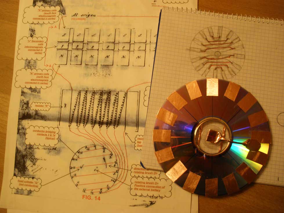

first pix are an idea to build the round tap system (not tested yet )

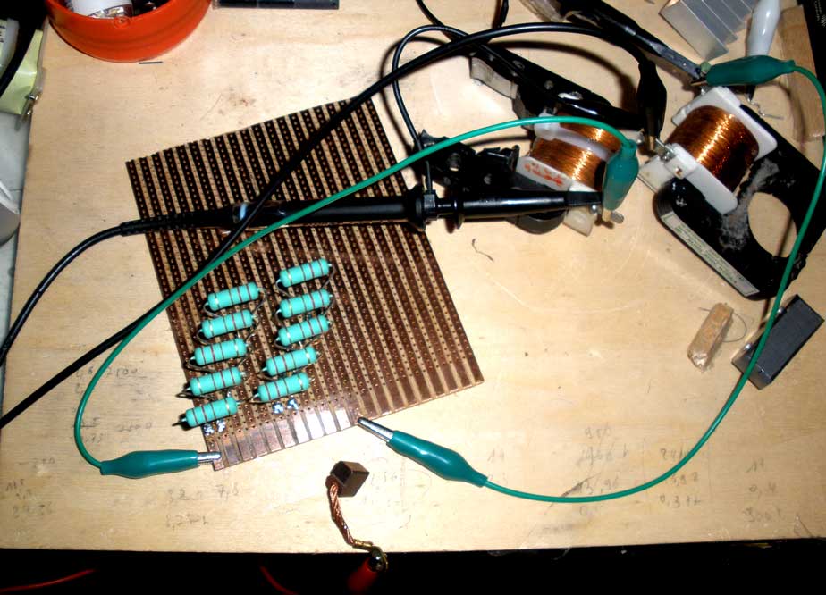

So as you can see (pix 3 ) , i have made a serial of 2.2 k ohm resistor (10 time 220 ohms in serie with 10 tap connector places ) and tried to slide by hand ,back and forth a brush on the connector (red wire ).

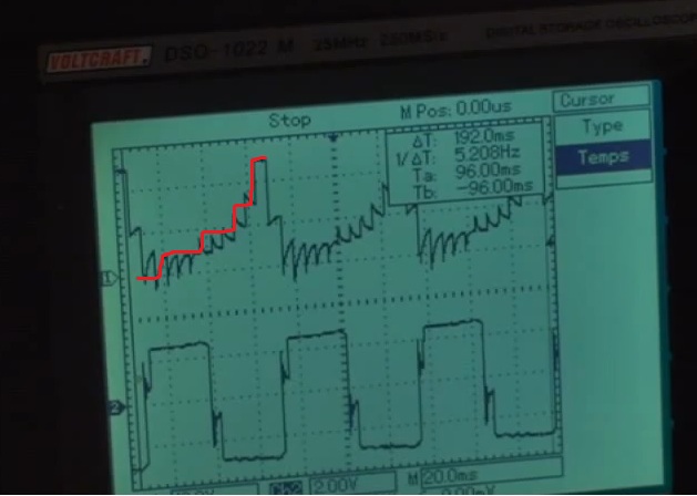

As you can see i can not get a nice u shape wave , but more an inverted u wave shape.
