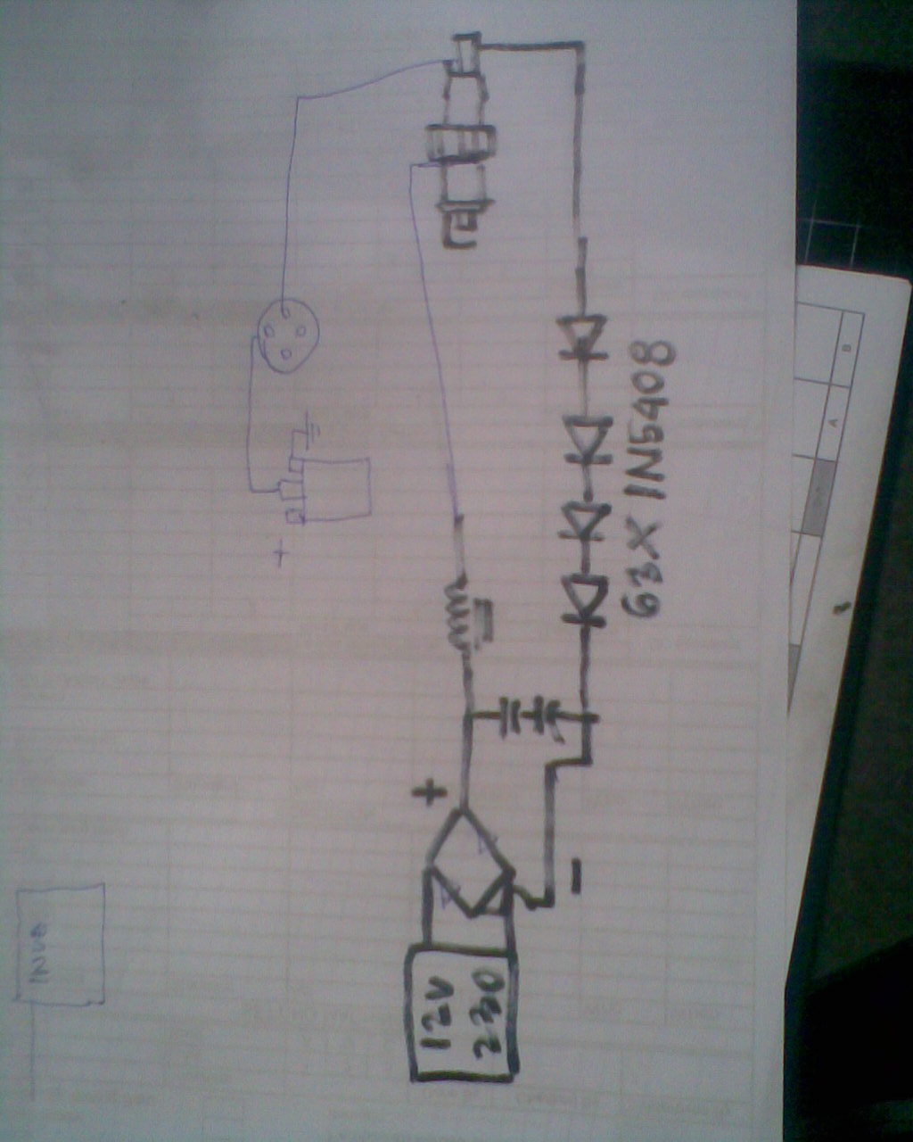

Im using an old version of nexus arc generator schematic in water spark plug pdf from panacea university. I changed the rectifier diode to full wave rectifier diode rated 15amp. MOT was changed with a transformer that only connected at the primary 12volt side. Hot wire connected to the transformer, and diodes string at the N terminal. Capacitor connected after the bridge rectifier before transformer. The L terminal connected directly to the spark plug. N terminal connected to the spark plug kathode. Hope u all understand
Hope this will help. Sorry about poor drawing.Attached FilesLast edited by topangler81; 02-24-2010, 09:23 PM.

If your high voltage output from the ignition coil of positive or negative polarity? I would lose the inductor and put the diode string on the positive line and the other way around

i think my hv is negative since i connected the spark plug at the negative of diode. Like in the diagrams. The oscillator diagram that you used very simple. What are the part no of transistor that you used?Originally posted by Jetijs View PostDo like this:

very simple oscillator circuit. at the circuit can i use an old 12v to 240 transformer? i think want to use it in reverse so it can produce 240v. and also ignition coil produce an high voltage, is 15 of 1N5408 enough to block the high voltage?
you using 15 diodes per spark plug of just one string to all 4 spark plug. sorry lots of questions i ask. just to make sure.
I think you can use your transformer, but see if it works on higher than 50/60Hz frequency. I had a problem one that my oscillator eas working on about 4KHz, but the output could not handle a load more than 10W. Turned out that the problem was the too high frequency. A transformer from an old UPS should work fine at higher frequencies. A string of 15 diodes in series should be enough if the gap between you spark plug electrodes is not bigger than say 2mm. And you need one 15 diode string for each spark plug. You can also use microwave diodes, this saves a lot of space, they handle 12kV at 500mA.It's better to wear off by working than to rust by doing nothing.
i think that i will use larger capacitor value to reduce the oscillating frequency. now i using 65 diodes on my diodes string. hope this will not exploding the battery againLast edited by topangler81; 02-24-2010, 11:27 PM.
is larger gap need more diodes or less?Originally posted by Jetijs View PostI think you can use your transformer, but see if it works on higher than 50/60Hz frequency. I had a problem one that my oscillator eas working on about 4KHz, but the output could not handle a load more than 10W. Turned out that the problem was the too high frequency. A transformer from an old UPS should work fine at higher frequencies. A string of 15 diodes in series should be enough if the gap between you spark plug electrodes is not bigger than say 2mm. And you need one 15 diode string for each spark plug. You can also use microwave diodes, this saves a lot of space, they handle 12kV at 500mA.
