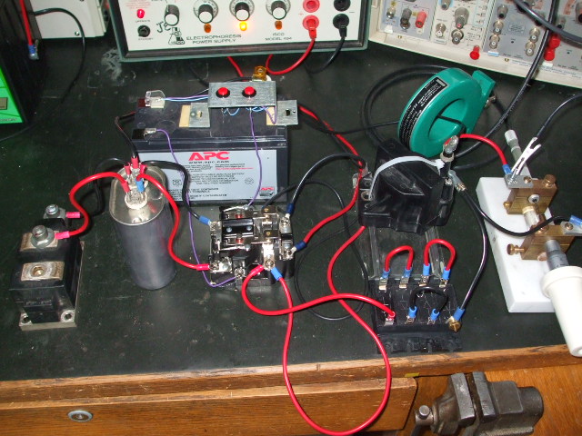

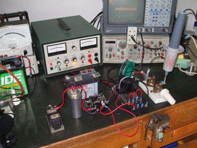

                  • RF Burst Observed in Bench Test of Gotoluc Circuit
                    Gentlemen,
                    It appears that a sawtooth RF burst does take place in the Basic Gotoluc circuit almost like the SPICE III simulator describes.
                    This is not an exhaustive study but a simple test to see if it was there. The gap is composed of tool steel with the negative (ground) electrode being sharpened. The effect is much greater when the gap is opened up to just short of were it will not arc. In this case the gap is 0.284". The storage cap is a 25 uF 600V oil-paper motor starter type. The power supply is voltage regulated at 300V. The battery operates the contactor to isolate the capacitor from the power supply during a pulse test. The capacitor shunt diode is a little overkill for this application (770 Amp) but I needed something that would handle 30 Amps. The HV diode is a 4-unit string of 8KV at 4 Amp microwave oven devices. The coil is a GM wasted spark model ($3.00 at the local junk yard). This coil has an isolated secondary which might be important because it allows for the polarity of the secondary to be reversed (See SPICE circuit on previous post).
                    The first scope trace shows the voltage across the gap as measured with a Tektronix 12KV probe. The probe is being driven past its linear range for the initial pulse but it does show the follow up burst wave form OK. The effect only shows voltage swings around 500V. This means that the arc will re-strike at a much lower voltage than the initial breakdown, which is around 15KV in this test, but way off the screen.
                    The second scope trace is a time expanded version of the first trace. Here we see the sawtooth nature of this process. Notice how the magnitude of the wave train remains relatively constant. The frequency of a single tooth during this portion of the burst is around 116 KHz. The actual frequency content would be higher than this due to its shape. This sample was taken from the last third of the burst where the frequency is slowing down anyway.
                    It will be interesting to see if this effect can be enhanced.
                    This observation might help those OU theories that require a HF source to explain any proposed non-classical process.
                    Spokane1

                      • WOW Spokane1
                        you are very seriously equipped!
                        Again, your test data is most excellent
