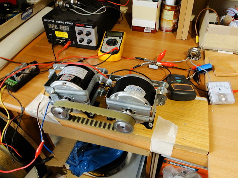

                              • I am jealous. Definitely I will do that in due time. Have to finish some other problems first. Thank you wantomake for the detailed progress. It will be very helpful.
                                The modified motor I made with my friend can be made better. After all it was my first try. These days myself alone(!) I rewound the small MY1016, I made three strands to one litz wire and corrected the timing. The motor runs cool. 3300rpm-15V-0,73A and 5620rpm-24V-1,57A.
                                One thing I cannot understand is that connected to bigger mod motor which I test as generator and the output through bridge and capacitor, the voltmeter still goes all around the place and I cannot take measurments. The capacitor I put in parallel. Does anyone know how to be able to make meter show the exact voltage?
