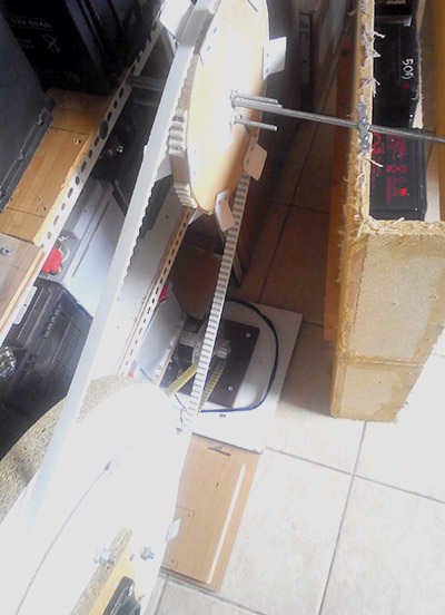

          Last days i was trying to put together a flywheel (like Chas Cambell) and 3BGS with modified motor and MY1020 as gen. I 've not concluded yet but with the setup i have mod motor has not enough power to accelerate the large flywheel to high rate. I managed around 500 cycles per minute for the flywhell, around 1100 for motor, with 12volt battery. I am afraid to put 24 volt because my setup is not very strong as you can see at the pictures. I think i will rebuilt a new one.
          Wantomake, a lot of people get sick this time of the year, myself also, but getting better. Do you mean you rewound MY1016 motor, or you are referring to the new gen you are making.
