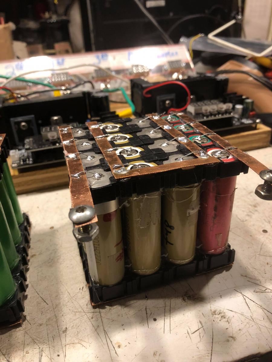

Still slow go with the modified Dave generator. In the mean time been assembling lithium ion 18650 size battery packs. Each one has 14+- volts each bundle. One bundle is 16 batteries each. 4 batteries in series as each row has 4 in parallel. One bundle powers the modified Matt motor fairly well. With the warm thaw it allows time to get some crazy tests out of my head.
Not sure how the lithium ions will react to the 3BGS setup with one bundle wired backwards. As these type batteries are fire hazards, don't try this unless you are knowledgeable of their dangers.
I plan to replace my solar bank with all lithium batteries. The life cycles is much longer with higher amp hours.
Just trying to keep up with modern tech while trying to improve the 3BGS setup.

Very much looking forward to data on the lithiums. They are fire hazards or at can be but those are the lithium cobalt and other variations.Originally posted by wantomake View PostStill slow go with the modified Dave generator. In the mean time been assembling lithium ion 18650 size battery packs. Each one has 14+- volts each bundle. One bundle is 16 batteries each. 4 batteries in series as each row has 4 in parallel. One bundle powers the modified Matt motor fairly well. With the warm thaw it allows time to get some crazy tests out of my head.
wantomake
They're expensive, but LiFePO4 - Lithium Iron Phosphate batteries are not fire hazards, safer, more environmentally friendly, etc.
In either case, the advantage lithium batts have over lead acids besides being constant voltage batteries (lead acid are constant current) is that the ions are a fraction of the mass of lead acids - their internal impedance is a fraction of lead acids so theoretically, they should charge faster, a battery being put in "rest" mode shouldn't have to be in rest mode as long since there is less momentum of the charging mode to absorb fully by the battery, etc.
I've seen mixed results with LiFePo4 used in Bedini SG setups for example - it would be very interesting and important if you are able to exploit their advantages in the 3 battery setup. Supposedly, lithiums do not like to be pulsed with spikes or cap dumps and are more suited for steady current, but I have also seen situations where that didn't seem to be an issue.

It has been hard to build the little lithium ion packs. Don't like soldering ends of batteries. But after doing a few got the hang of it. Reading/studying the methodology, there is much quicker and effective spot welding setups. They use the thin silver strips and tack them on each battery. I will use that method as I progress to larger Tesla wall units. Jehu Garcia has very good channel if anyone needs to know.
For testing purposes just smaller 12-14 volt bundles will be safer and easy as a starting point.
I only paid $1 each for 50 of these last year plus the few I had already from old laptop battery packs.

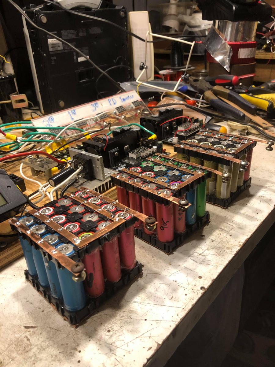

Lithium packs
The lithium-ion packs didn't do well.
After looking at them I understand why those that use them have so many in one block. Just not enough amp hours in mine to hold up. But did take my crazy testing ideas. If I can afford hundreds then will use them in solar setup with 3BGS as backup.
Not a total waste of time.

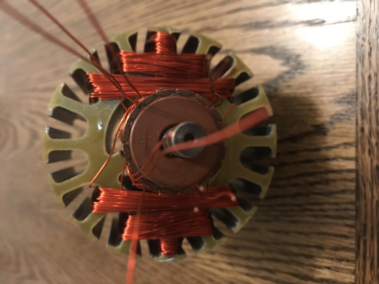

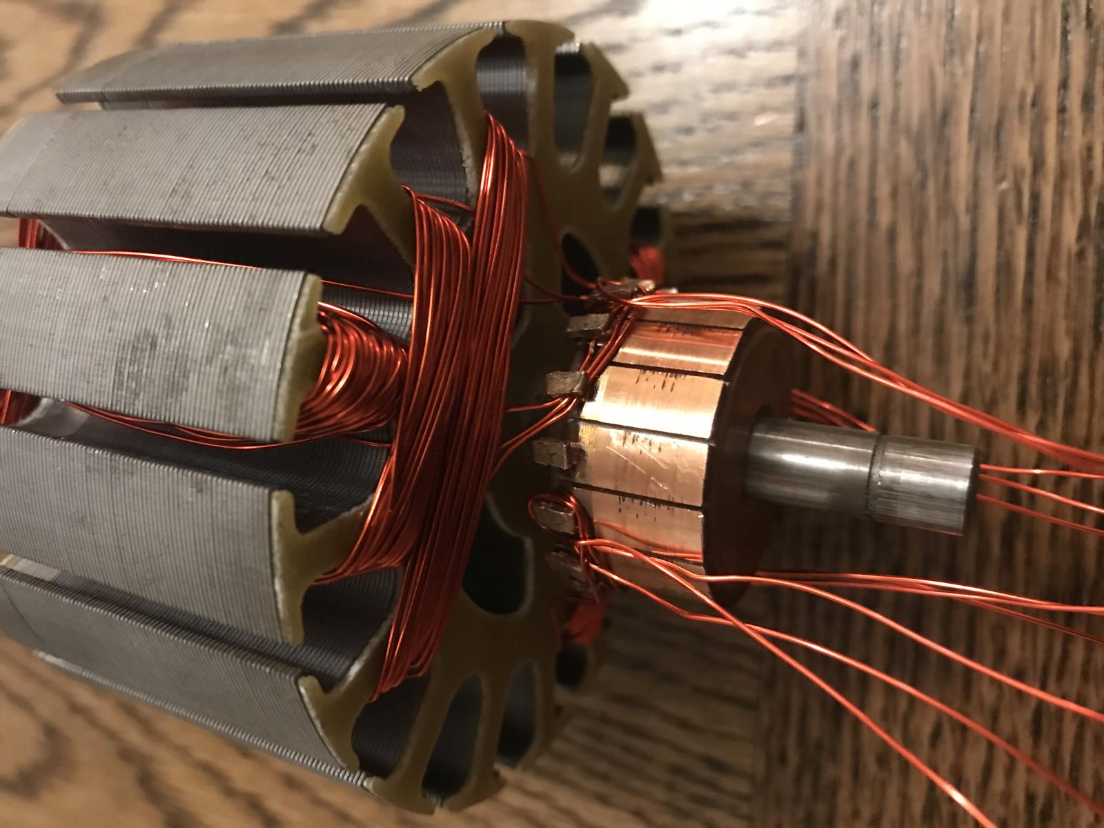

It looks like you have (1) single wire wound around each coil. No. You keep the three wires together at all times. Parallel to each other. Side by side they make one wire with three strands in it. Look at Matthew's video again, the first one.Originally posted by 2600 View PostTonight I wound the coils. I haven’t cut off the excess and soldered yet. Currently I have 3 coil ends together under 3 lugs, then I skip a lug and the other 3 ends are together under 3 lugs. From an electrical standpoint, are the 3 ends of the 3 coils supposed to be tied together under 3 lugs? This part was baffling me as I would assume each coil wire would get it’s own lug. Thank you in advance!
[ATTACH]20386[/ATTACH]
[ATTACH]20387[/ATTACH]
Jameson (just like the whiskey)
I don't know how wide the (3) segments are on the commutator is. Open or bend back the three tabs carefully. Clean the lacquer from ends of three wires same length as the width of the 3 segments. Place that end with three wires together into the three segments. Gently bend the tabs down over the three wires. Three tabs hold the three wire ends. I used a small flat head screw driver and my hand to push it down.
Now go up to middle first rotor iron to start winding(refer to the video) the coil. As you look at it you should wind clock-wise. 40,30,30 wind all the coils with the three wires together as one trifilar wire.
Hope this helps. Matts videos really explains it in good detail.

I thought you got the winding part as far as the diagram shows. But you asked about each coil getting it's own tab or lug. I'm sure I answered your question correctly. You've got correct winding pattern just had the tab connections question.
Hope my answers helped,
wantomake

Wantomake, yes you answered my questions about winding the coil properly. I ended up buying 3 spools of wire and pulling the 3 strands of wire off the spools as I wound the coils. All of the 100 total turns on each side of the rotor are continuous trifilar wound.
Jameson
