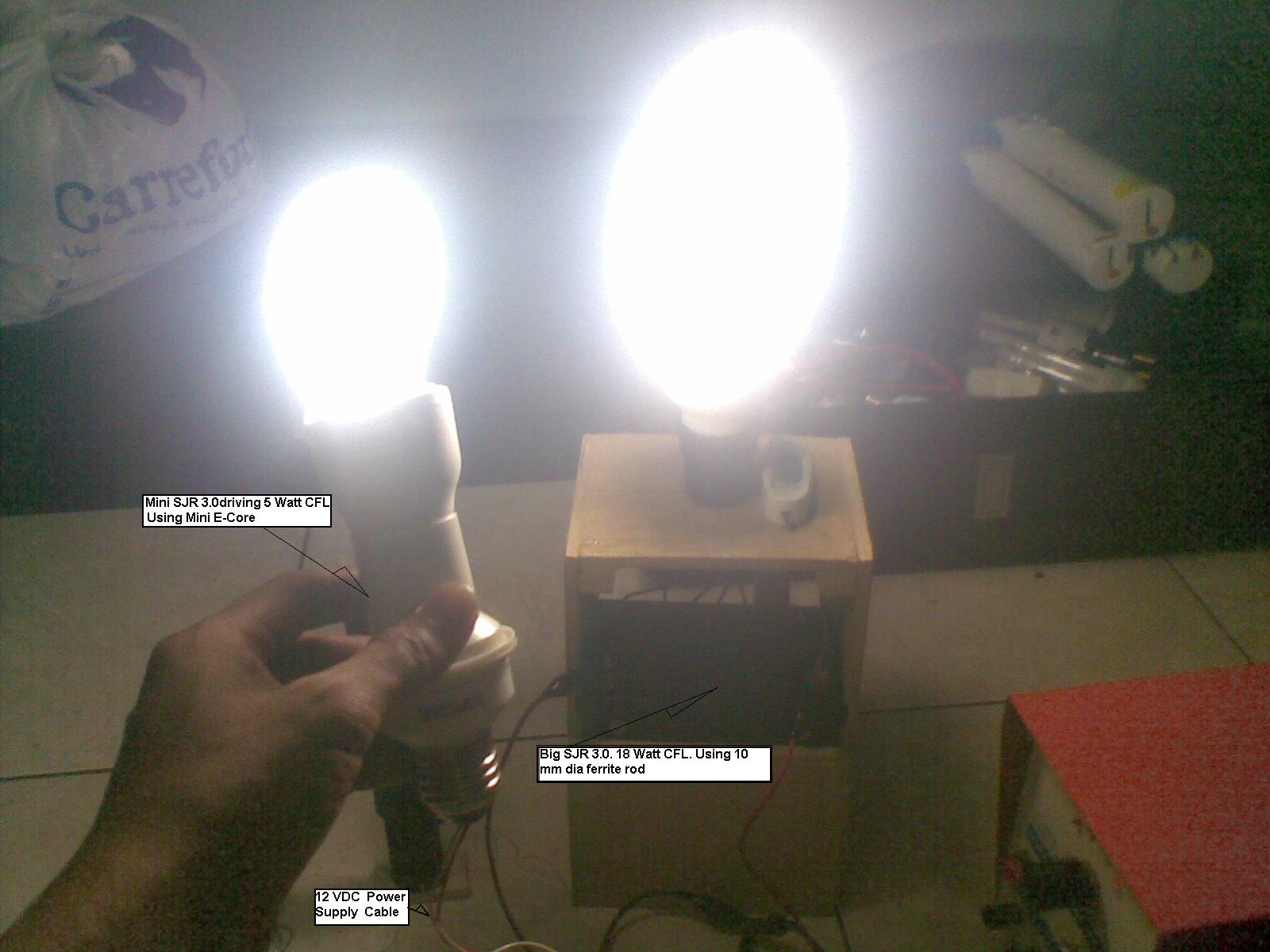

    SJR 3.0 Mini
    Another my SJR 3.0. This is mini SJR 3.0 since all component (transistor + heat sink and Transformer) enclosed in E-27 fitting.
    Here is the video :
    SJR 3 0 Mini E Core - YouTube
    Here the picture :
    Rgd
    Djoko
