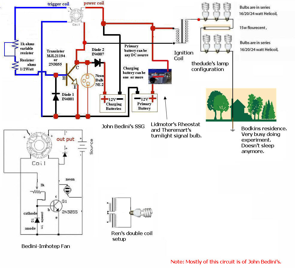

Thanks agongon thats really funnyOriginally posted by Agongon View Postesaruoho, nat1971a, Soldyur, and others like us:
This is for you all. I hope it serves a purpose and solves some confusions.
This is open for correction...as always.
Again my thanks to everyone especially John Bedini and Imhotep.
YES THANK YOU MR BEDINI AND IMHOTEP
If i ever get to meet you imhotep im making you godfather to my kids,
one thing is my resistant is a 4.7pot and a 1k pot to tweek.
Looks great Agongon people can work form this, Cool
