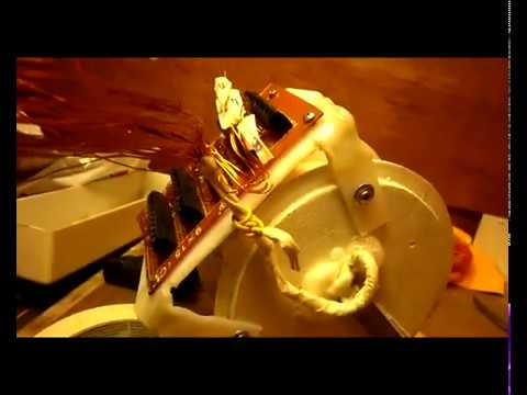

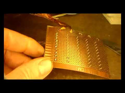

C core coil update. Jordan has soldered 50 terminals on the back of the circuit board and now we also have the board mounted to the spool with 10 of the other 50 wires being locked into the positions needed to form a 50-filar coil. Be done soon. The 10 terminals done are 72 feet per strand so this is 720 feet. The reading is 22.8 ohms while the 23 awg magnet wire rating shows 32 ohms per thousand feet.
