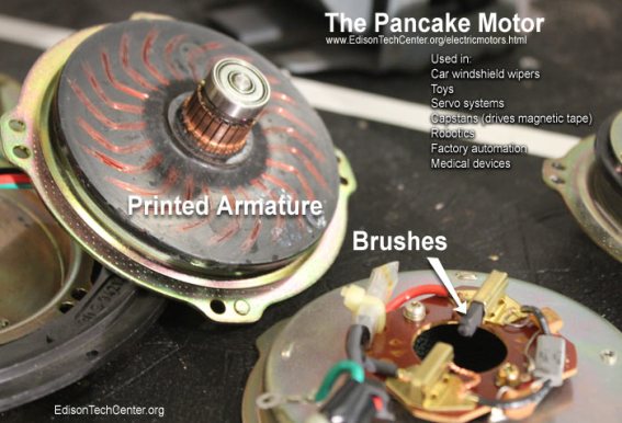

    hi dave. if it looks like in the pic, and if you can't feel cogging when you turn the shaft, that's likely what it is. separation was fairly easy. the backing magnet held it all together. closing it back up requires a little bit of care so as not to damage the brushes. as you know, some of these pancake motors are said to be very efficient as is. over 90 %
    cheers.

    hi dave. i found a pic of the internals of the thermofan motor i mentioned on page 8. i read that they need about 6000 rpm to make about 13 -14 v with some amps. as a motor they can be pulsed if the frequency is about 40-80 khz. as a gen, no core losses helps. there is some drag in the bearings and the brushes. a coupled pair might go well. i got 1 of these motors. maybe with a flywheel it could be a pulsed motor-gen.
    cheers.
