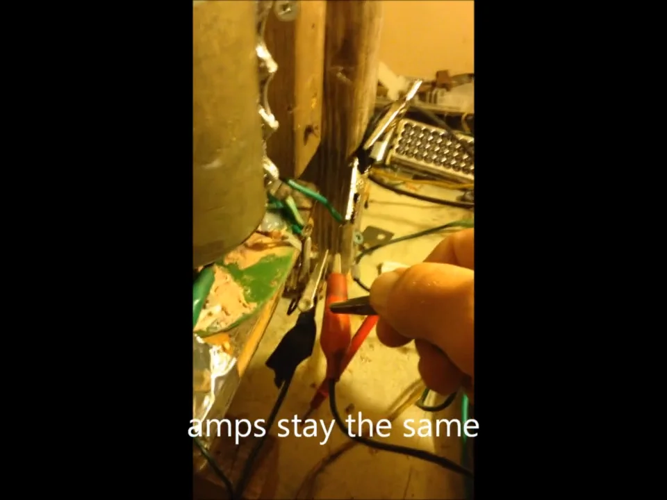

    Using the single battery setup from the above post, I've run numerous tests without much to report except...
    Over a 30 minute test, the voltage would drop about .02v, the amps would drop from 450mA to 430mA, BUT the rpm goes up from around 1652 rpm to 1836 rpm! It's freaking me out. The input drops and the rpm goes up.
    I tune the setup by running the motor fast, then adjust the pot to a "sweet spot" where the amps increase if I add or subtract resistance on the input. This is the lowest amp draw with the motor rpm high. (This motor seems to run in only one speed range, or it runs down and stops.)
    The changes in voltage, mAs, and rpm all happen gradually and steadily over the time of the test.
    Bob

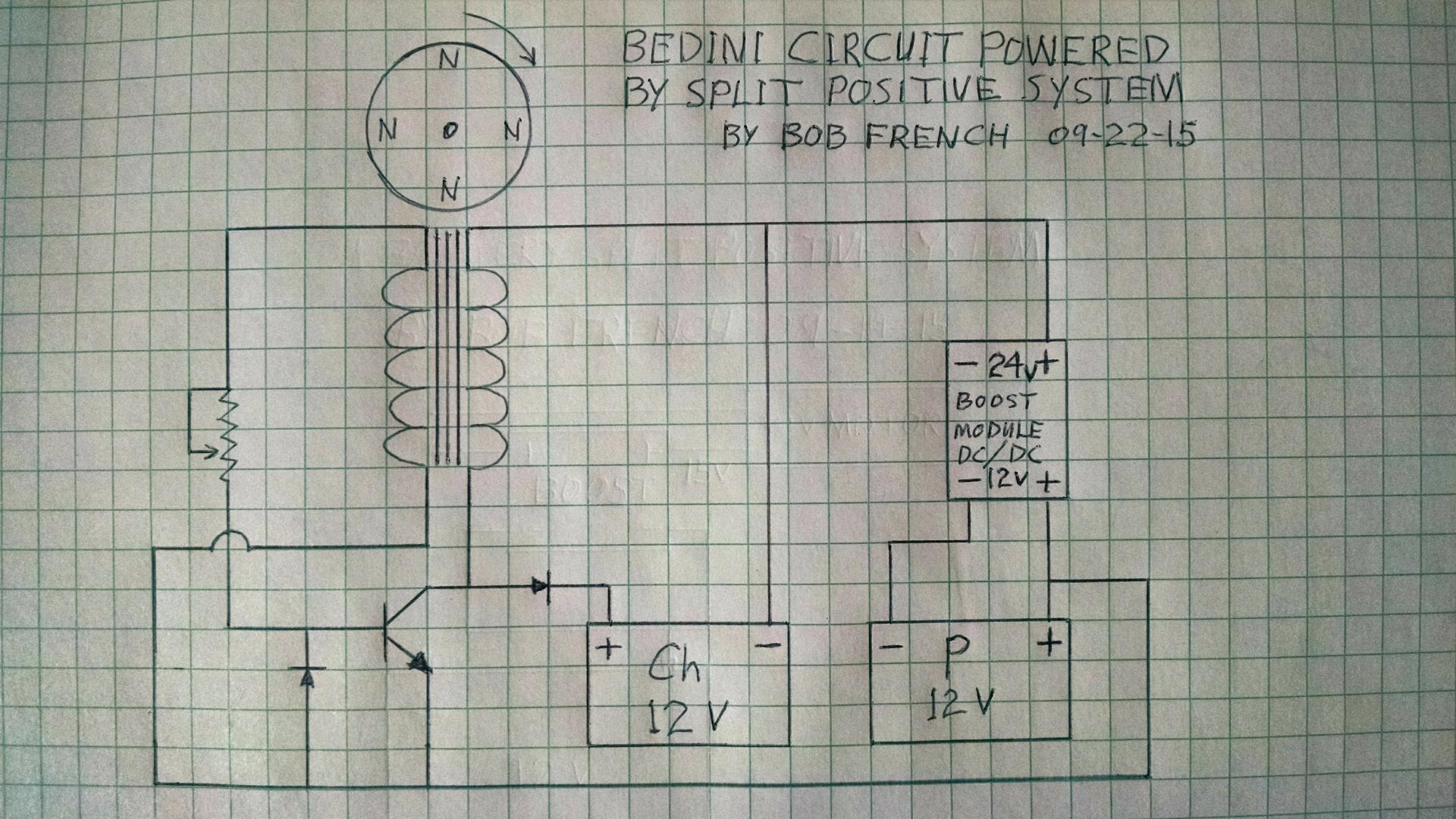

    Back to my last post...
    The first time that I ran this setup, in 30 minutes the Primary dropped .01V and the Charge battery went up .19V. Then I had to leave, so I left it running. After 7 hours, I stopped it, set those batteries aside to rest till morning, and started another run with other batteries to run over night. Since that first 30 minutes, every other run has been loosing!
    I've seen this too many times now and I don't get it. Maybe someone can illucidate.
    Below are the two circuits. They run, they charge, but no OU so far.
    Bob

    1BSPS w/Bedini
    Hopefully some parts have come in when I return home tonight.
    This week in the truck I tested the 1BSPS w/Bedini setup (attached below) with no great things to report. I didn't really expect anything, I was just surprised that it ran on the Split Positive. That shows me that transistors don't care that there's no "true" negative. We're just running on a difference in potential.
    I am going to change it up some and try again with a separate trigger in the energizer and use the 2BSPS w/Bedini setup when I have "extra" time. lol
    Bob

    replied
    simple but interesting scheme bob.i guess both negatives on the booster are connected internally, or on a common rail.
    cheers.
