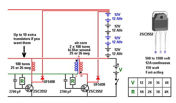

    Hi mainsen
    I used the exact components of the photo i posted, only the drive battery was a 10 Ah, over three years dead and revived a bit (meaning i would be lucky if it had 60% capacity) so I used another one of the same kind (but even less capacity). Totally two parallel drive batteries. But I think it mentions somewhere that the system might work better with 24volt drive and implies good, not dead batteries! Charging batteries were 4 7Ah. I used two coils one bifilar, one slave! The specs exactly as in the book. Maybe few more turns on the bifilar. The amps from the drive were around 550miliamps. I count and found that I used much less energy from this system than using my normal charger CTEK MXS 5.

    Hi liber63,
    nice to see your post, because thats exactly what I also wanted to try, Turions 3 Battery system combined with Alexkors BEMF charger and a 4th (or more) battery charged by it.
    Sadly my Alexkor seems to perform underunity, though it works great for refreshing and charging batteries. May I ask you about the specs of ur Alexkor, you use only the bifilar coil or additional slave coils too? Wire diameter, turns? With what battery you drive it, what batteries (and how many in series) do you charge with it?
