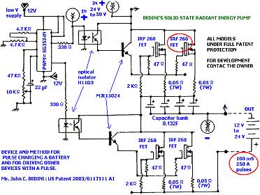

                Now let me address the pulse timing of John Bedini's energy pumps and dumps.
                John B uses 100MS timing for pulses. Here is one example and I need someone to tell me why I am now asked to shut for a timing in the nano seconds or a 1ms pulse??
                What has changed in 11 years, please someone explain.
                Also everyone should note the red circles in the picture. I am enraged. Why?
                Simple, because I didn't notice JB mosfet numbers for a 24vdc max system, instead I have been looking at diagrams on these group lists produced by people who mean well but really haven't found which end is up on this stuff.
                IRFP260 mosfet is the one I just picked up as I looked for the right voltage parts after blowing many 250's.
                So john B uses H11DX opto's producing a 100MS yes milisecond pulses.
                See the patent photo above. This diagram is not out dated, trust me.
                My question is what did this wave form probably look like? And why should we be changing the timing to nanosecond pulses when John uses 100MS yes miliseconds.
                Hello? Any takers or are we just building our own new design? That is okay if that what the nanosecond pulse topology is all about.
                From what I understand experimenters want a variable range of pulse timing using the slow rise times and long "ON TIMES" to start the charging sequence and as the batteries fill the rates can be altered to any desired pulse train for finishing and maintaining battery charge.
                With this in mind we can then look at the micro-controllers to perform the changes based on battery type as well as voltage.
                Yet I would still like to hear someone express how John's H11DX opto's became suddenly obsolete for use with cap dumps and how discharges effect batteries better.
                This question is only for those who have built these circuits and know something more than speculation please.
                It seems that if 100MS yes thats right microseconds (mS) is good for John's batteries why should I change it? Or what question should I be asking?
                Or is that figure 100mS "ON TIME" ? It can't be as Mario has pointed out Opto's are slow and rise times are in the uS.
                If you understand my question please give the answer. Maybe 100mS is "ON TIME"??? I wonder what the rise time is? On this pump diagram what would be the fastest rise time possible?
                It sure wouldn't be 10ns and it wouldn't be 500ns yet it could be somewhere around 30uS.
                Any ideas let me know.
                Thank You.
                Mike

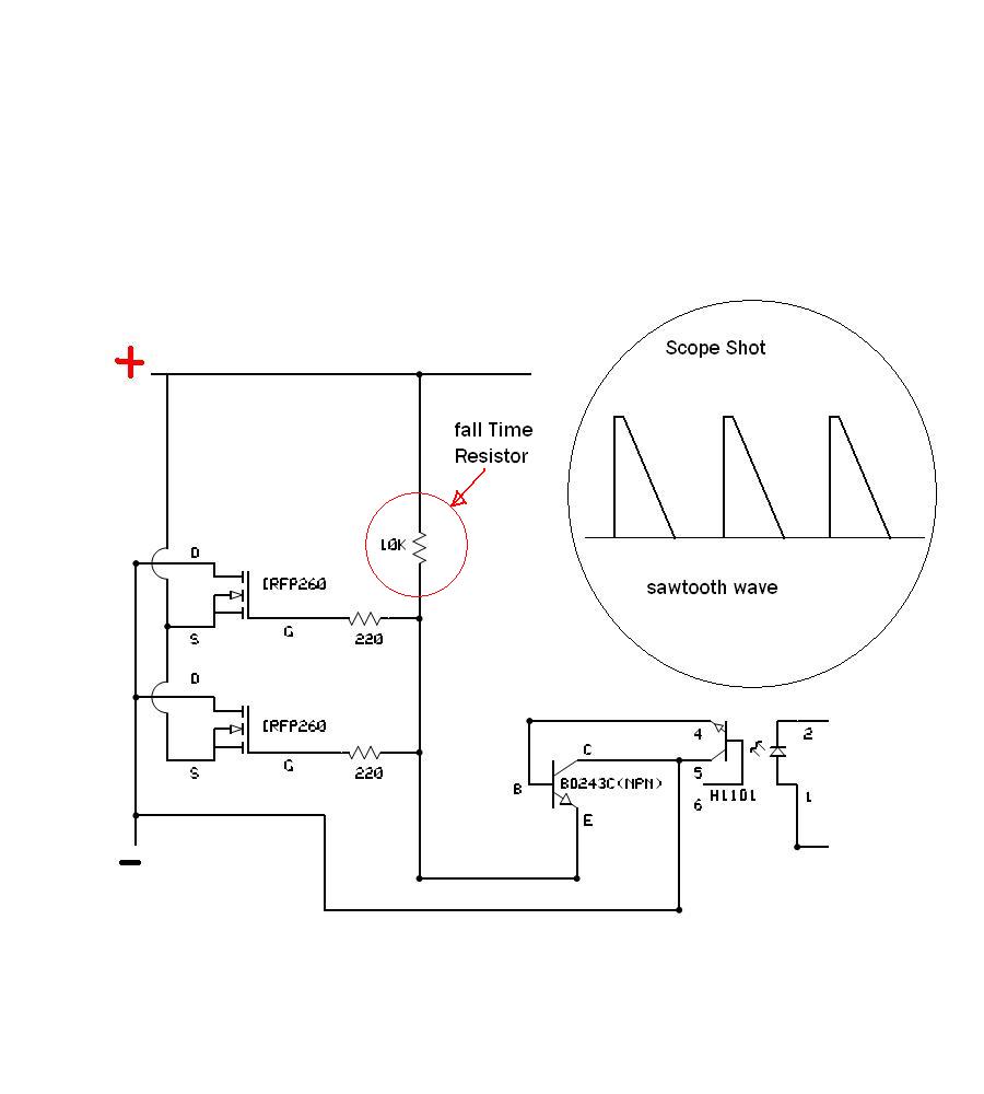

                  Here is another example of a voltage divider found on the John Bedini's wheels.
                  It uses a slow Opto for rise times AND a 10k ohm resistor to pull the Mosfet back shut. I know beyond a doubt that this resistor only permits a sawtooth wave form. Fall times for this resistor is 250-500 micro-seconds.
                  here is a partial circuit.
                  So why do these waveforms produce sawtooth when they are supposed to be square wave. Square wave is not sawtooth and sawtooth is not square wave.
                  This is the way all Bedini pulses are formed.
                  Anyone?
                  Again this is a very detailed question only for people who understand these circuits BY building them. No speculation please.
                  Thank you in advance for from input.
                  Mike

                    @ BroMikey, check the partial circuit polarity labeling !! Dupe
                    • See what I mean?
                      Hi Dupe
                      I found this on the web. See what I mean about the garbage you find on line sometimes.
                      Anyway the polarity was not my focus. I am wanting experimenters to look at the voltage divider starting with the 10k ohm resistor.
                      The claim al around the web is that this circuit produces a square wave. That is bare faced lie. This circuit produces a sawtooth wave form.

                      • circuit diagram
                        Here is that diagram for a sawtooth waveform
                        I removed the plus sign.
                        Mike

                                Again let me stress the significance of a circuit that produces a sawtooth wave shape. I this simple wave a transistor or Mosfet is turned off with a resistor. This is a crude way to turn off a Fet and produces this wave form.
                                Notice the cap dumps in a very short time and all of the wasted time after it fully discharges.
                                Very poor management by comparison to a state of the art drivers ability to turm off the Fet or transistor.
                                It is my understanding that a sawtooth wave shape is a starting point for beginners.
                                Opto's can turn on faster than 1 ms say a normal speed of 100uS or less and this is fast.
                                It is the turn off time that we are concerned with here in order to come out of the beginners box. Turning off a fet or transistor is the point.
                                Does anyone see all of the wasted time in the diagram and do you realize that the after the cap is done discharging that the Fet does not shut off for three times a long as it is open?????????????
                                Anybody?
