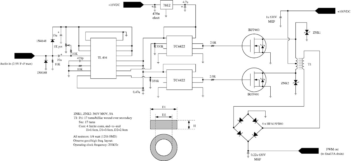

                Also here are some circuits that are all grown up and qualify for handling higher power with longevity in mind.
                In the bottom picture this man was able to drive 4 Mosfets using his own driver with the PNP and NPN toggling like found in prepackaged drivers.
                My circuit needs to handle 80vdc at 10amps. 800watt power circuits are far more involved if they are to last.
                Industrial apps say that any device operating at 80v and above should be designed using 500v ceiling devices and at present all I see experimenters using are the 200v devices.
                So what I have decided is that since my circuits keep burning out i will use 12 mosfets and another more advanced circuit for controlling them.
                I will show a picture of my home made heat sink with devices soon. The fan and 4 devices are installed already.
                Mike

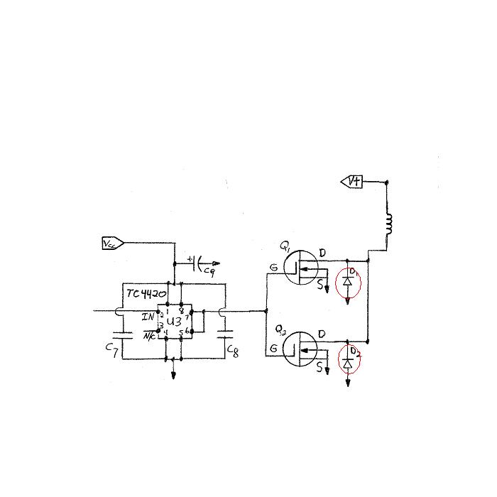

                      Diode
                      Here is a diagram of what a friend used when he built a driver for 250n Mosfets that power a coil.
                      I am wondering if these diodes protect the mosfet from spiking? If anyone knows the answer please let me know. The diode number is HFA08TA60CPBF Diode Hexfred 600V
                      https://www.youtube.com/watch?v=rtsuxU2VxOU
                      In this video we see mosfets of low power being over driven to a potential 300volt reverse spiking. People seem to over look ratings. a 200volt fet is best suited to work at 50-60 volts under heavy motoring loads.
                      Mike

                            Hey John
                            Good Idea here is my working circuit, not this mess I am making lately.

                            What do ya think boys? Hey John show me a shot of where to add my cap to steady the transistor.

                            • #74
                              Proper circuit 36vdc/90vdc Cap discharge
                              Here is a proper lay out of what a cap dump with it's ratings for Mosfet's should be.
                              This circuit can handle the reflected 3X spiking that can occur.
