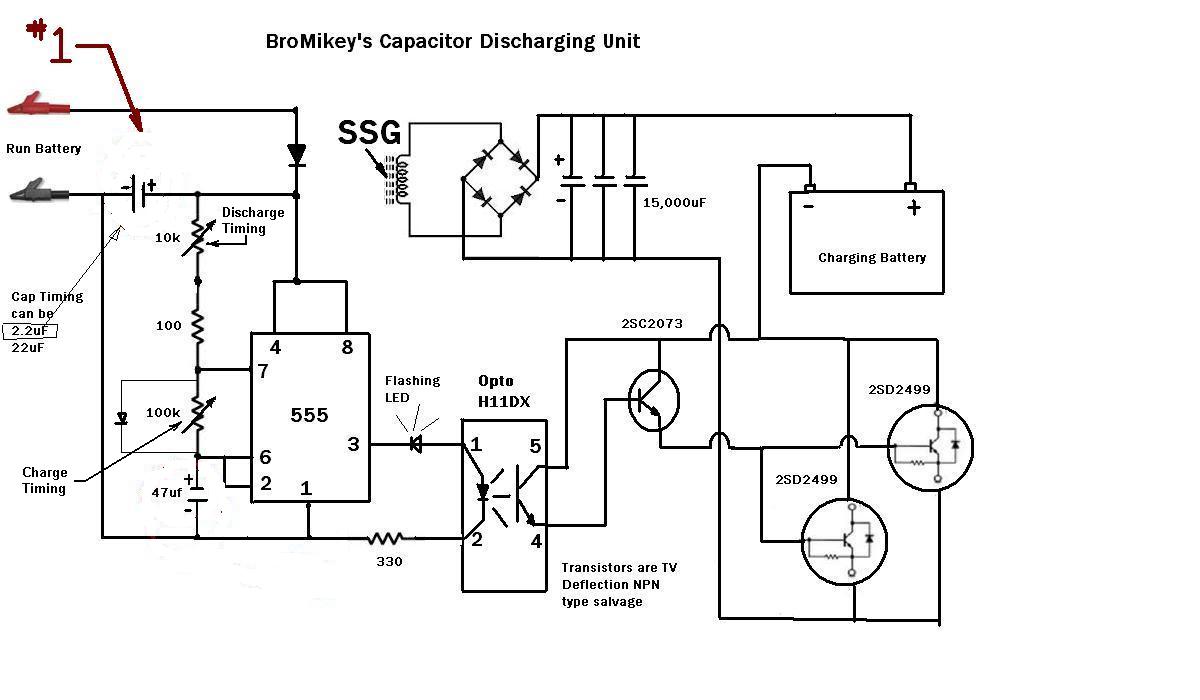

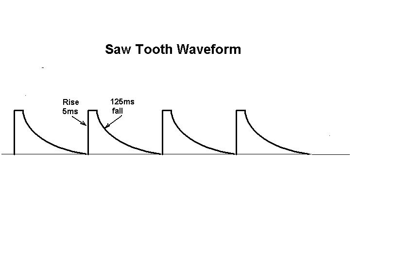

Disregarding the power dissipated by the switch due to slow rise and fall times I
think the following holds true.
Basically with a total Capacitor dump the rise time of the driving pulse which is the
close time of the switch is most important in order to begin max current flow
quickly.
But with a coil discharge the fall time of the driving pulse which is the opening
time of the switch is more important in order to collapse the magnetic field
quicker, which in turn causes a fast voltage rise from the coil discharge.

Hilarious
That is the funny part. Oh and real easy to build.
