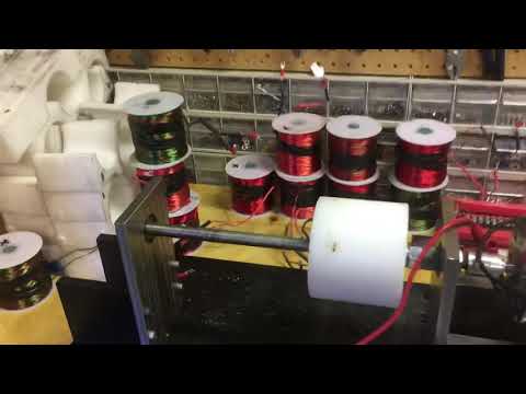

The original machine was 12 magnet N/S rotor. When we built Black Beauty we put 22 magnets in the rotor all N. It didn’t work, so we cut the rotor apart to get all the magnets out and the new machine has a 24 N/S magnet rotor. We are using the 12 magnet machine as a coil tester because we know that whatever results we get, they will be better on the NEW machine when it is all put together. Since it is finally raining here in my part of Northern California and I can’t work on my outside projects, I have time to work on my inside ones.“Advances are made by answering questions. Discoveries are made by questioning answers.”
All the previous machines except Black Beauty had all-thread for a rotor shaft, and I filed the threads off the ends to fit in bearings. Not exactly a "machined" or "professional" build. But it worked well enough for proof of concept. Lots of corners were cut to save money. Black Beauty was the first really professional build, and even now, I see an issue. Just running black beauty for the time I did, I saw wear on the shaft where the bearings sat. I think the shaft was spinning in the bearing rather than spinning the bearing. I may have to lock the shaft in somehow. The shaft is just cold rolled steel. Over time, that wear will be an issue. I will have to have a hardened steel shaft made. But it will last long enough for testing and demonstrations, and then I can put it on the shelf.
Got all the opposition magnets in yesterday. That is a process. I only have one blood blister from magnet pinches, and it isn't a bad one, so I feel lucky. I hope to get the rest of the machine assembled today. With any luck, I will.

So here are the facts. The old clunker machine with iron core coils was able to put out between 1800-2000 watts. The input was 36 volts at 12 amps and with adjustment we could get it down to 7 amps, but it wouldn’t STAY adjusted. Too much play in critical areas. The mechanical issues were addressed, and my hope was that this NEW machine with twice as many magnets on the rotor would be more powerful. Perhaps TWICE as powerful.
And it may well be, but I am not using the same coils because they heat up too quickly and melt the coating off the wires after about 30 minutes of constant running.
So I have been busy doing the thing I like least in the world, which is winding coils while my partners in Sacramento cut, coated, and epoxied in the core materials. They also tested coil pair for output on the old clunker and shared the data with me which I posted here.
They would send me videos of coil tests and kept track of data so we could make a decision on what core material to use. One of those videos is what a few people here saw. There is a problem with the testing that was done. The numbers are open circuit voltage numbers, not voltage under load. This wasn’t clear until watching the videos a few times and I called to confirm. By the time I realized the issue, I had already picked up all the GOOD coils and brought them home. So the voltage under load test he did yesterday was with a pair of mismatched coils and ones that produced LESS output than the wiring configuration we are using on the GOOD coils. BUT, the test shows that these new coils don’t put out NEAR the voltage of the iron core coils. Only about 55-60%.
My hope is that the GOOD coils put out enough more than the mismatched coils that with a 24 magnet rotor I will be right back up to the original 1800-2000 output of the original generator. But I am very aware it could be less.

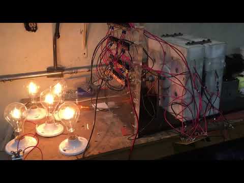

But I want to be clear about a few things. The measurements I took on the original coils were ALWAYS under load, so those numbers are accurate. I first time I fired up a coil pair the bulb didn’t light up and it took me a bit to figure out I had blown it. And a coil pair blew two 100 watt bulbs in series. It lit 3 to brighter than when connected to wall voltage and increasing the RPM would blow the bulb, so I am very aware of the voltage and amps I was getting because I used an oscilloscope as well as several different meters.
But as to total output of this machine with this new core material, it’s an unknown until I see it run on the bench. And if I want to win the bet with bistander I might have to put all the old coils back in it. I could. But I am curious to see what this machine will output with these new coils and will go from there. This motor could turn a second or even a third rotor. That would be a much bigger machine, so I will probably leave that to someone else.
oh, the mismatched coils under load were outputting 77 volts at 1.3 amps. Not even close to the 120-130 volts at 1.5 amps the iron core pair put out. But that’s with a 12 magnet rotor. I don’t know what MATCHED coils will do on a 24 magnet rotor yet. So it may be back to testing core material. We still have a couple we didn’t test, but I wound the extra coils already.“Advances are made by answering questions. Discoveries are made by questioning answers.”
Data
300 watt bulb yields 77 volts at 1.3 amps
100 watt bulb yields 180 volts at .9 amps
