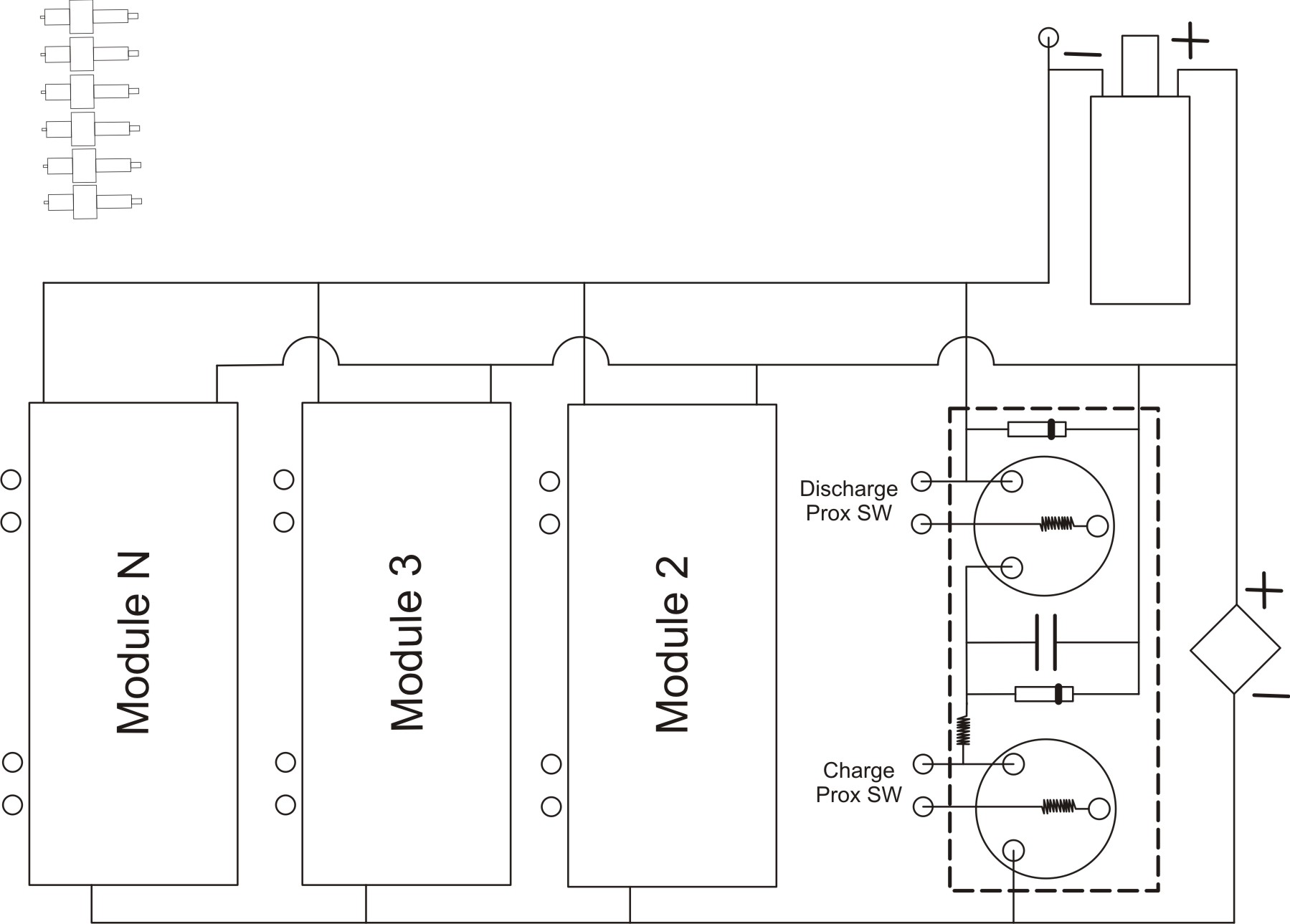

                • Modular Approach ?
                  For an ICE adaptation of your system, could it be arranged as a modular system like the drawing below ? This would provide plenty of cycles to charge the caps. Or do you think it would easier working with a higher frequency/voltage power supply ?
                  Timm
