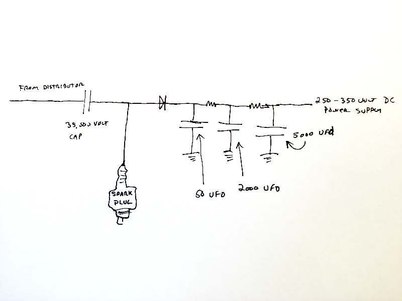

          • Proposal for simplified spark plug circuit practical application
            I am following with great interest this setup you guys are working on. THe ultimate idea behind it is to dump a capacitor through the spark plug gap upon the spark plug firing. So I have come up with this circuit as yet untested and the diode may the wrong way around but maybe. some might want to try it out.
            The output of an ignition coil is basically a high frequency AC pulse, so it should go righ throughg a capacitor, so I put a 35,000 volt cap between distributor and spark plug. This allaws the highvoltage spark current to go through and fire the plug but at the same time will block the low voltage DC from the capacitor bank from going into the coil.
            The capacitor bank consists of a three stage filter system. a largeu cap to maintain a steady supply of DC at 250 to 350 volts or however much you want. the first cap after the power supply is the storage. it fills the next cap up through a resistor and the next cap get filled through another resistor. the last cap goes through a high voltage diod and hooks to the spark plug. the cap next to the spark plug can get totally discharged when system fires, the next cap in towards the pover supply only gets partially discharged and the main storage cap stays pretty much full.
            It will require some fiddleing around to find the correct values for the resistors. this type of setup was used back in the days of Tube amplifiers to smooth out a DC power supply.
            So there you have it I have included a diagram to look at.
            The idea behind this system is to work fast enough to run an engine with without requiring a giant DC power supply. so every time a spark plug fires a cap dumps its load through the spark plug and by the next time that spark plug is ready to fire again it will have a fully charged can to dump again.
            this system would require at least one cap to dump into each each spark plug, possible two and one big supply cap they can all feed off of.
            Any way this will get rid of all the relays and outher crap the original circuit has and take the ignition coil out of the look completely except to make a spark to fire the gap and then the capacitor bank taeks over and dumps its load through making the big bang.
            This is all still theory as I have not set it up yet. I got my 35,000 volt caps already but still have to collect parts for the rest of the setup. so if anyone wants to try this even as a work bench setup hope you post your results. remember the High voltage diode may be the wrong way around on the diagram.

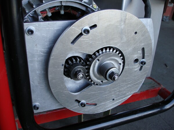

            • new progress photo
              Hi everyone,
              Here is an update photo of the progress I'm attempting on my generator set adaptation of the water spark plug ... AKA plasma spark plug.
              What's been added since my last update is the timing plate. As you can see I have added ample adjustment for the timing in the form of the three circular or arced slots. The timing plate will hold two diametrically opposed reed switches (for now). The driven gear (big one) has three threaded holes (visible) for mounting the rotor piece containing the magnet that will actuate the reed switches.
              This set up can be adapted to work with any number of affectors and/or sensors ... optical, hall, cam & points, etc.
              I love this forum and this project! Peace,

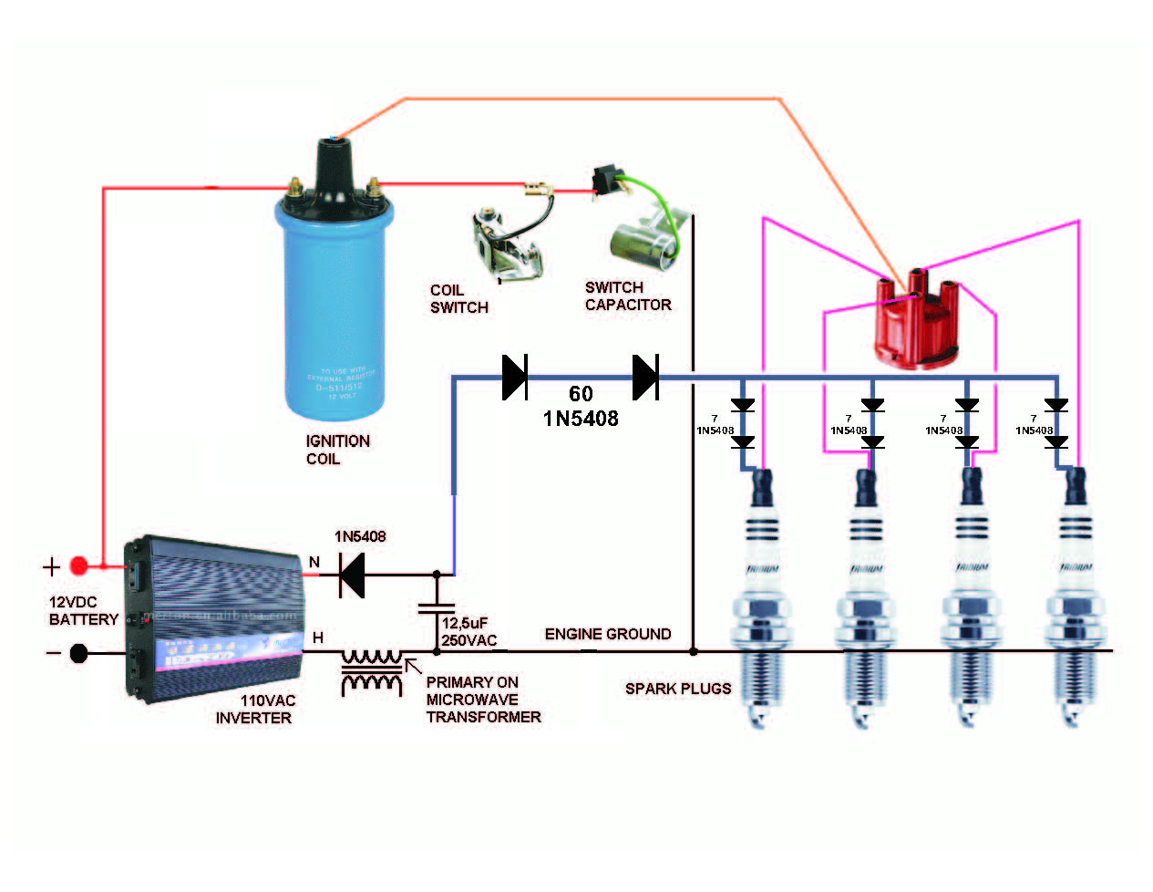

                      • Nexus Plasma Arc Circuit
                        This is an attempt to diagram the Nexus circuit and a call for assistance.
                        from overunity.com forum...
                        I have made a cleaned up drawing of the circuit. I did not get the number of diodes used.
                        Also, in the car he used another string of diodes. Where to put them?
                        Can anybody that are better in understanding English than me take a look at the video and update
                        the drawing with the correct number of diodes and also where the second string
                        of diodes is attached?
                        Groundloop.
                        @Groundloop and everyone,
                        I am new to this forum but an avid watcher and would like to commend everyone on their great efforts.
                        I have edited Ground loops schematic with my representation of what Bill was saying in the video and the schematic he posted.
                        He stated that he has two banks of 60 1N5408 diodes in series, each at 3 amps 48kva. In parallel, he gets 6 amps. He stated that he feels he does not need two banks and he over engineered the circuit.
                        He calls the line coming out of the diode bank a "dipole wire". He runs 4 dipole wires to 4 banks of 7 diodes which he calls his "cross talk preventer". From each of these cross talk diode banks, he runs a wire to the top of each spark plug.
                        Like I stated previously, this is the way that I understand his circuit from watching his video several times and reviewing his schematic. If anyone feels that this is incorrect, please let me know. I am by no means an expert in this field and am open to advice and or criticism.
                        I am planning on replicating this circuit and will post my findings here.
                        LapperL

                              • Nexus Diagram revision
                                @ lapperl
                                I emailed Bill (the Nexus circuit video/.pdf guy) a copy of your diagram revision.
                                Here was his response:
                                The diodes in the 60 string are going in the wrong direction.
                                The ground for the capacitor should be to the battery, NOT to the 120 hot!
                                Cripes
                                When you geter done, could I have a copy for the PDF?
                                Much better than mine
                                Bill
