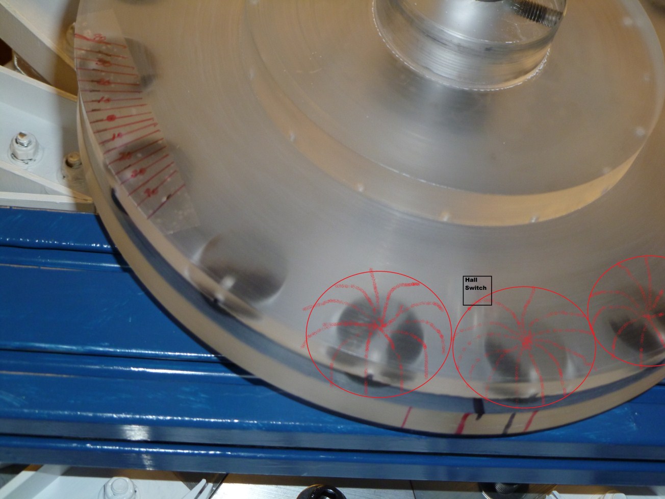

  • Michael Kishline
    Hall Dwell Arrangment
    Hi John
    You said:
    "I think that the timing wheel magnets are closer than 1 width apart. It's important that the fields can overlap. That way you can get a >50% duty cycle on the hall if you need it
    Greetings Vissie,
    As you know the flat ferrite discs gives off a toroidal (donut) shape field, so the Hall will catch the edge of the field to set the dwell, and if there is any vertical adjustment on the switch that will also lend to it's precision setting.
    This is how it works in my head anyway!
    Mike
    Merry Christmas to all!

  • Mark
    I have the same question as Nvisser. Wont the switch always be on if the field overlaps. Same thing with the 23 DEG past TDC, how can you set your timing to 23 DEG when the magnets are 22.5 degrees apart? You dont have 23 degrees to work with.
    IN post #36 JB states the machine is set up to emit between 6.85 to 7.1 HZ and the RPM is between 16.8 to 18. Can someone show me the math on this.
    In post #57 JB shows 3 halls and dwell timing. 3 pulses, small, medium and a large one. This is just an illustration of the 3 coils on the bottom, correct, we are not working with 3 halls.
    I'm sorry if these question are stupid but I'm really trying to wrap my head around this and am going back thru the whole thread to try and comprehend the function of everything. Please help me out.
    Thanks, Mark
  • Les_K
    Hi John
    Take a look at the data sheets for the hall switches. Pay close attention to the difference between Bi-Polar and Uni_polar. Might clear it up a bit, since the 3020 is a Uni-Polar device this might explain some of the timing.
    Les

  • nvisser
    Hi Vissie,
    I think that the timing wheel magnets are closer than 1 width apart. It's important that the fields can overlap. That way you can get a >50% duty cycle on the hall if you need it. Have a close look at the pic John B posted of the timing wheel with the red lines drawn on it.
    I don't think it will work with using the outer magnets to trigger the hall. The timing wheel magnets should be ceramic discs, not neos. I've found that the fields of the ceramic discs spread out from the disc a little bit, so the hall can trigger before it is physically over the magnet.
    Good work with the PCB!
    John K.
