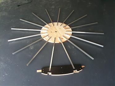

  • BrentA929
    6 foot wheel progress
    Hello All,
    We are SO EXCITED how our build is coming that we had to share the progress...
    And when I say we, I am talking about myself and my business partner Scott or better known as (Txaggie00).
    We completed one side of our 6' wheel today and hope to have the other side done by the end of the weekend. And if we're lucky we will have the A frame completed as well. We wanted to go much bigger, you know how we are in Texas, "Bigger is better," but we just didn't have anywhere to put it.
    As you can see we took a similar approach to John B with our design. We had two templates (center circle and magnet holder) cut out of metal at a local water-jet shop so we could maintain a very tight tolerance. We then routered out the wood while using the same templates to use as guides to attach the spokes. This allowed us to have a very precise construction. All the raw materials have been purchased from Lowe's thus far...trying to keep it some what simple and inexpensive.
    We have a lot yet to do and even more to learn! Looking forward to every moment
    @Luther - Scott asked me to add to this post that he sent you a PM
    Happy New Years, Brent
