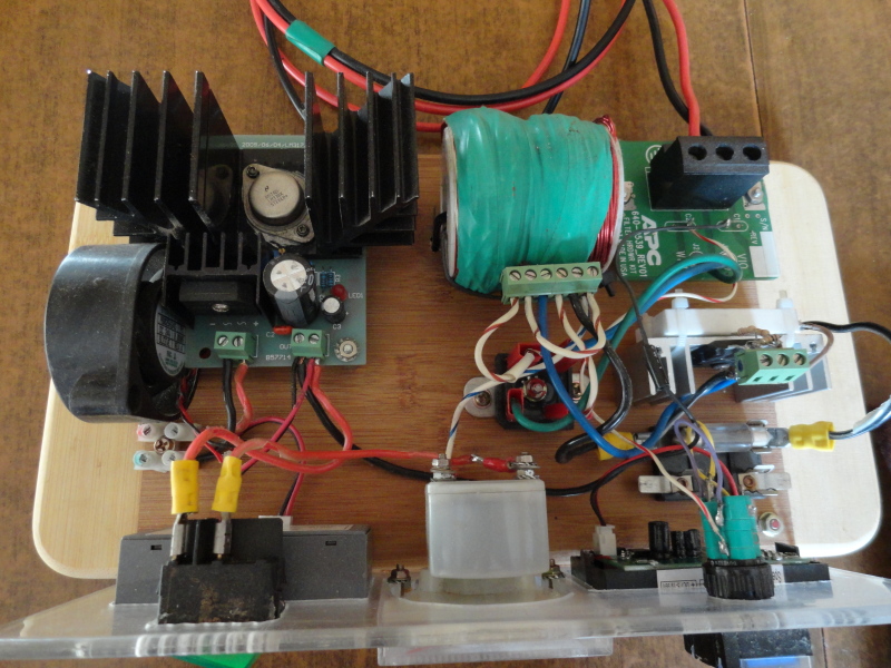

I wonder if anyone tried this yet? I'm gonna try it anyhow but would love to hear any feedback. Oh, I almost forgot - there is no coil
) based on trifilar - transformer style coil. What that means is that coil has three windings with same type and length of wire, so it is like a transformer 1:1:1. While first two are connected in typical SSG (with exception - there is no output diode from collector) third winding is connected directly to the AC pins of bridge rectifier. Both, "+" and "-" are connected to the charging battery, according to polarity. I built a few variations of this circuit before, experimenting mainly with wire thickness and length. I found AWG#18 giving nice strong pulse and 100' length optimal.
