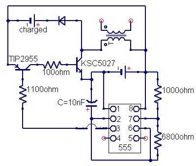

Performance of new circuit:
- output current = 400mA
- output voltage without load = 370V
- charge at +0.1V above battery voltage for two nicad in series.
- do not make the battery hot
- charge 1000mAh under an hour, much slower than previous one transistor version but has less surface charging property.
The circuit is now closer to Bedini standard mentioned by Aaron where the HV output should reach 400V.
YouTube - New circuit performance, 370V charging two nicadLast edited by sucahyo; 10-17-2009, 01:17 AM.

Hi folks, very cool pics blackchisel, very colorful. That's great, getting some practical use out of the technology charging a drill battery and extending its physical life. I myself went back to the 555 timer to pulse my coil to charge batteries because as I tested that circuit more, it was heating up the transistor way too much for my liking. I wish I could figure out why these self oscillators are heating up my transistors and fix it. Anyway nice setups there and thanks for the pics, I like colorful pics.
peace love light
Tyson
Hi Tyson, thank you for the kind comment. It seems that kids "used" my camera. It's working strange and out of focus
I found that duty cycle may be responsible for heating up transistors. Also, you can try to slightly increase base resistance.

About the TIP122 maybe it is dead so current passing trough the transistor without beeing switched at all. See if it get very hot. I use heatsink but even with 0.4A charging two nicad it only get warm. Two nicad has a lot less internal resistance than 12V battery so can be considered as the highest load of my circuit. The one wire neon at transformer secondary will still show pulsating light when charging 12V, but it won't when charging two nicad.
Performance data charging two 1.2V nicad (1000mAh):
Input: 0.7A @ 10.4V = 7.28watt
Output: 0.45A @ 3.2V = 1.44watt (at full battery)
Efficiency: 19%
Performance data charging one 12V gel SLA (7Ah/20hr):
Input: 0.62A @ 10.5V = 6.51watt
Output: 0.24A @ 13.1V = 3.14watt(initial voltage raising before going down)
Efficiency: 48%
It seems efficiency going up when charging battery with more voltage, I guess this is the reason 12V source is used to charge 24V, also the suggestion to add more load. Just realize that current circuit is much much better in term of efficiency compared to previous one using 3055. I guess reducing the heat from 555 by using higher resistor value do help.
