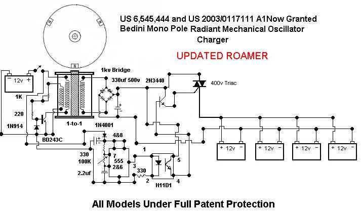

                      • need help with power coils and trigger coil
                        What kind of reed switch in particular would be an allaround good r.witch to use for the ssg's?
                        I need to know if this (the bedini monopole radiant mechanical oscillateor Charger) uses 2# 22's (power coils) and 1# 26 (trigger coil).
                        Obviously, this is a tri-filar coil i just need to make sure of the sizes of the coils will some one please enlighten me?
                        Thanks for yas help!!!
                        • here is the schematic
Name:	mono_pole19 radiant mechanical oscillator charger.jpg
                          here is the schematic. sorry i forgot
