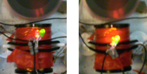

                • Hi Guys,
                  following Lee's experiment with the trigger choke under the strobe I have done a few tests which have revealed a few things about my motor.
                  The main thing is it's sweet spot is double pulsing. If I tune it so that is pulses once per magnet it shoots up to about 4500 rpm but draws around 750ma so it isn't as efficient a sweet spot.
                  Here is a strobe shot of the pulses with the choke in the circuit on the left and without the choke on the right
                  So with the choke i am getting two solid and very brief pulses with a delay equal to the length of the pulse in between. the pulses are roughly between 9 and 28 degrees so the total pulse is for 19 degrees of rotation.
                  without the choke there are two long pulses with a brief delay in between. The pulses occur roughly between 1 and 35 degrees so the total pulse range is for 34 degrees of rotation.

                    • "Sephiroth slaps himself on the head"
                      DOH! I just realised!!! with a six magnet configuration the pulse range musn't be over 30 degrees or it will start to repel the next magnet!!!!
                      Revelation: The reason I am getting improved rpm for amp draw is that without the choke my set up is putting drag on the rotor by repeling the incoming magnet for 5 degrees! wasted amp draw!!!
                      but with the choke it sits perfectly within the 30 degree range! no amps wasted! No drag on the rotor! Eureka!

                          wait a minute... it shouldn't even be able to pulse after the 30 degree mark! the incoming magnet should turn off the transistor at 30 degrees!
                          is it possible the switching time on the 2n3055 isn't fast enough and is causing the elongated pulses?
                          Perhaps my measurements are wrong... I'll double check.
