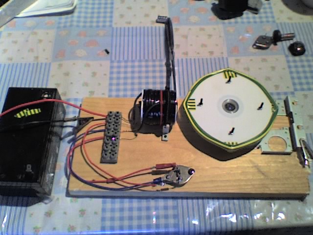

          this is my machine in just motor run setup
          450>500 turns on coil, 22 26gauge. mild steal core made from small file set.
          680ohm resistor only, and sod the pot, far more efficient than anything i seen.
          not tested it till battery runs out but it went for well over 36 hour until i had to play with it.
          it is going to charge batteries very soon, i like it
          ps to ren. thanks for info site on current measurment. again

              @ Rusl. Good clean first build. Are they neos on the rotor? Air gap is HUGE! Could make some improvements there. Keep at it.
                    I thought so too thank you,
                    Not neos no, they tiny nuts and bolts holding bunch of CD's tightly together. had problem deciding on a rotor so i crafted one.
                    it spun for less than minutes when took that photo. a knife is shunting heat from core. huge air gap =no vibration at present state.
                    Improving it at every thought. chopping wires down, got hdd motor to try. etc.
                    kindest regards..............Rusl....... more pictures very soon thank you
