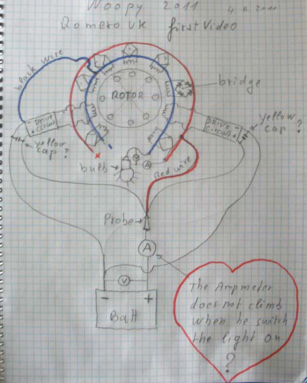

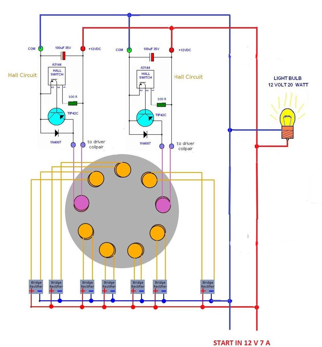

        • wiring diagramm
          hello all
          my English is not so good so i try not speak a lot but to give some points with diagrams.
          Unfortunately i don't have an actual dynamo because it needs an amount of money to make it, but i think that i will make it soon.
          very nice work from all and thank for searing
          @Lidmotor and woopy
          i love your work indeed but i have questions
          is this the woopy diagram?
          can you please tell me were we have to place the cap and the dc-dc supply?
          also
          this is the original diagram:
          we can see 2 caps. is there an error? or we have to think far out of the box and maybe with no logic at all and make that???? :
          thank for your time and everything!!!
          good luck at all!!!
          Regards Pascal
