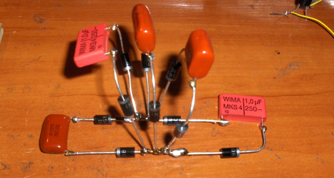

                  Hi Sucahyo !
                  Let s answer your questions one by one :
                  1. Output of my three stingos while charging the batt. = 180mA (input 340)
                  2. Output of my single stingo while charging the batt. = 180mA (input 350)
                  You see : this 10 mA difference (340-350) is too little to be consider as
                  anything significant, that is the problem that i am talking about....
                  3. Regarding diodes, i used until today 1n4007s, but after i today saw
                  your notice about minimum requirement of 2 Amps i went to store and
                  bought bunch of 1n5408 and i of course at once tested them hoping that
                  this was the problem, but unfortunately nothing happened, maybe some
                  slightly, slightly improvement that i can not even register with my meters...
                  4. picture of my combiner :
                  5.Yes, i combine my circuit like this above !
                  In fact, when you see my combiner you will see everything because you
                  know how this thing works, if anything was wrong than you would/could
                  notice that in that picture of my combiner, am i right ?
                  Finally, stingo is superb, i am not disappointed at all, but of course that
                  i would be even more content and after all these problems HAPPY, if we
                  could solve this problem of NOT RAISING EFFICIENCY connecting more
                  stingo together !
                  It is also kind of contradicting to common sense that more stingos dont
                  give more power than single one...
                  I just do not know what else i could do to solve this problem.
                  The only one solution is to wait and see if Father of stingo could figure out
                  what is wrong here.
                  Rgds !
