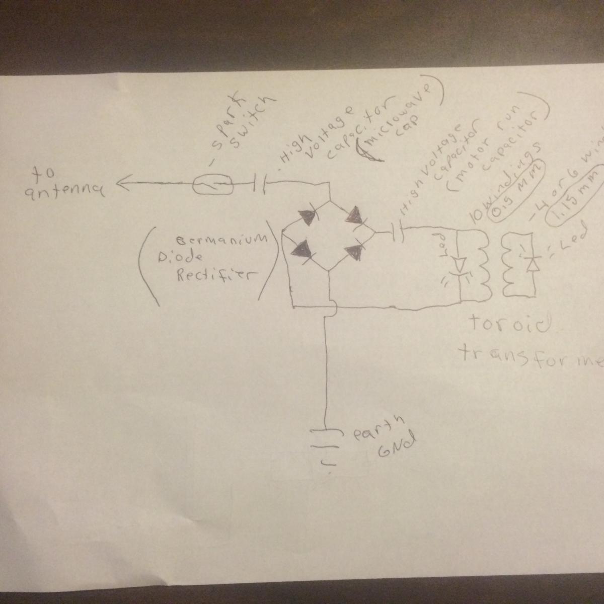

        Ok so i removed the toroid transformer and used a ac to dc converter circuit and ran some charging tests and i was supprised at my findings .
        i removed the spark gap switch i made and hooked my antenna set up to it without it ( as it is in most of the scematics you find around the net) the readings are as follows

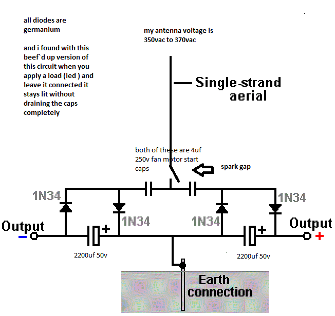

              ok i beef`d up this dc charging circuit a little and connected a load (led) to the dc out and it stayed lit without draining the caps so this is looking promising...

                Ok i didnt like the results from the above schematic for some reason the readings were all over the place after a few days... but i made some mods that are working good as of now and that is i built a full wave rectifier from the germanium diodes and enclosed the spark gap (as suggested in an above post) and after the switch i put a 1uf 2100 vac capacitor ( microwave) then through the rectifier into another 25uf 370v capacitor ( window ac unit motor run capacitor) and into a toroid transformers primary and an led across the secondary its staying lit up very well with 10.7 to 11.5 vdc constant across the primary...this is looking promising to say the least...
                oh i almost forgot the current is now a few milliamps so im thinking of a few of these rectifiers in parallel to boost current and/or a few more antennas and hook them up before the spark gap switch to boost current ...

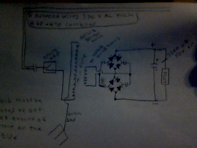

                              i had some very interesting readings last night because of an electrical storm that moved through my area ...my origional 370vac jumped to over 1000vac at times which was interesting in itself however the current was fluctuating from a couple hundred ua (normal) to the ma range and once to 3 a wow!!! that was fun...
                              but on a different note i modded my circuit again by moving my spark gap ( found a few better ones in old pc monitors) after the hv cap in series with the antenna then to an air coil transformer with 100 turns on primary and 15 turns on secondary then to a modded rectifier ( nonpolar caps across the dc out of the bridge) then a electrolytic cap across the output to the load...( load being incandescent bulbs) tried one from an old flashlight worked well but blew ofter letting the cap build too high ... then went to a 12vdc test light bulb its working as of now but only if i let the cap charge first then it drains to 5vdc and the light goes out...
                              its comming along it seems...
                              i repeated these results 3 times im going to do it again after work if no storms move in...
                              • #90
                                Ive modded my circuit again and went with and air core transformer i wound myself as of now. i tuned it before i hooked up the rectifiers as to get the max current by removing windings from primary or adding them and the same for the secondary after i squeezed as much current as possible through it i hooked up the second part of the circuit which is a modded version of what ive been using ... i can now run an led array of 24 leds at full brightness continuously ... no extra power source just the antennas but ive been trying to pull a larger load like incandescent bulbs but they drain the capacitor to 0 the only way i know of as of now is maybe another type of low voltage spark switch across the cap to the bulb with maybe some type of transistor or thyristor maybe...dunno yet but ive attached a rough copy of my setup check it out let me know what u think...and any suggestions will be greatly appreciated ...
