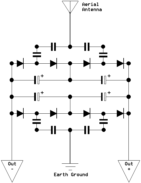

          Regarding the circuits, the first one is a crystal radio. Google that and you'll find countless pages on it. Basically, a signal comes in via a resonant circuit (inductor and capacitor), is half wave rectified (via diode), and delivered into a high impedance device (headset).
          With a large enough aerial capacitance (antenna), you can pick up an AM radio station and hear it quite well.
          The next circuit is basically the same, just geared for high voltage.

              Yes. It works, but extremely low voltage. Only a couple of millivolts.
              I built one and tested it. It generate about 1 millivolt indoors and about 2 millivolts outside.

                The one in the video is only this...
                yes, the two capacitors in series are important,
                Don't replace them with just one capacitor instead,
                it is one of electronics lil' hidden items that does work.
                I covered this waste of money in a
                couple-o-three posts over the other place...
                Question from the Tesla generator video series
                It boils down to this:
