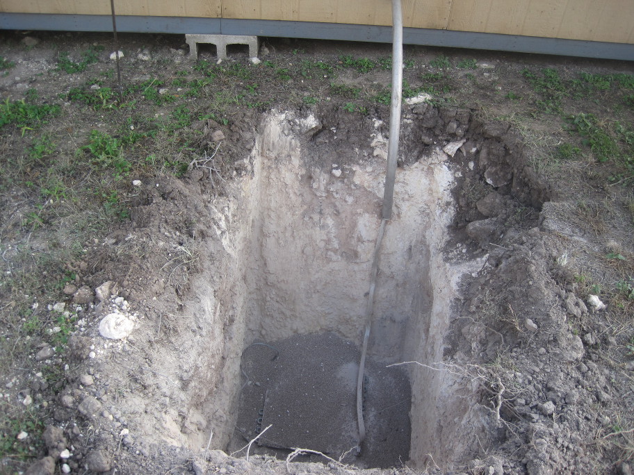

    Yes, I agree with everything you wrote. Meanwhile, here's the latest progress on the nuts-and-bolts of the project. The ground plate is installed now, here's the process I went through.
    First I tried to solder the big braided cable to the copper loops of the radiator. This was unsuccessful and resulted in nothing but frustration. I have considerable experience with electrical soldering but a lot less with plumbing and using a propane torch. Maybe someone with more experience could have done this successfully, but I quickly realized that I wasn't going to get good results this way. Instead I used the aluminum flange of the radiator and fabricated a cable clamp to tie the ground braid to.
    Next was the ground enhancement mix. I had a significant amount of chemicals left over from some years back when I dug a deep hole for a ground rod, so I just used all of what I had left. This is two 40-pound bags of pelletized gypsum and about 35-40 pounds of fine granulated sodium sulfate that was left in the bag.
    Installed in the hole it all looked like this. First a few shovelfuls of the ground enhancement mix to kind of level the bottom, then the ground plate (conveniently my clamp arrangement was strong enough to use for lowering it), then the rest of the enhancement mix on top of and around before backfilling.
    I wet all this down with a hose and put the (mostly clay) topsoil in the hole first, hoping the clay content will also help to retain moisture. Then another sprinkle with the hose. Then I started shoveling in the remaining material, trying to get mostly the finer stuff without any big rocks. Then another dousing with the hose. Then, once the ground plate was well covered and protected from damage, I used my compact tractor with front loader to scoop and dump the remaining material, pausing every few loads to wet it down. This is what it looks like now, I'll do a little finish leveling by hand but I want to leave it concave so it will trap water with every rain and stay moist underneath. You can see that not all of the excavated material packed back in the hole, so now it's looser with some porosity to it than it was originally. This should act kind of like a french drain and allow surface moisture to percolate down to the ground plate area, at least that's my hope.
    Ok, so after going to all that work how did we do? I wanted to measure the resistance between the building ground rod and the new ground plate. I checked and there was a slight voltage difference between the two, no doubt due to electrochemical action. However, this means that a regular voltmeter resistance reading won't give a true answer. A better solution is just to hook up a battery between the two connections and simultaneously measure the voltage and current. Using a small gel cell, I measured 12.55V and .201A, for a calculated resistance of about 62 ohms. Considering that the building ground is just a standard 8 foot round rod of about 1/2" diameter, it seems logical to suppose that the majority of the resistance is happening on that end of the connection. If this is the case, then the true resistance to ground for my plate is perhaps 10-20 ohms? Without better measurements I'm just guessing, but it seems like a fairly low resistance considering the difficult soil conditions I have to work with here. So at first glance it seems like all this trouble (and some expense) was probably worth it. I now have a good quality, low resistance (and low impedance) RF ground for tying experiments to. Now I can get back to experimenting to see if I can get better results!
