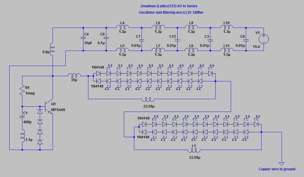

  • Originally posted by ren View Post
    Hi all.
    Dr, that circuit worked a treat, straight out of the box. I got some limited results, until I fiddled around with the second inductor (the one marked 2-20u on your diagram) and inserted a rf choke/inductor of the correct rating. They look almost identical to a resistor. I also used a 22u one off the collector.
    I tried inserting a small variable capacitor in parallel with the 400pF silver mica.
    But I cant vary it without effecting the circuit. I have another I will try which has a plastic tuning wheel.
    For the moment I get my best results with the LEDs joining the 22u and not connected to the second tower. I had some trouble connecting it to the tower and getting it to light. I think I need to get more inductors out to try, or a little ferrite slug which I can adjust. The only way I could get it to light was connected to the 37th turn tap. Connected to the aluminum tophat gives me nothing.
    In the photos the second tower is connected to the 22u, as well as the LED's.
    They sure light up bright
    Thanks for your help Dr Stiffler and all. Looking forward to more tinkering.

        I have the two towers connected on this setup this way:
        Tower one coil to collector directly. Bottom of tower two coil connects to top hat of one. Center taps are not used. Tuning is done with the slug on the tunable inductor. The circuit is standard. Basically I followed Mutten's setup. Tower one takes the place of L3.

          All of my post is in reference to your site you linked a few posts back with the diagram of the SEC 15-3. I referenced the numbers and letters (22u, 2-20u etc) from it, the only abbreviation I was unsure of was the "Lb"? All others are near identical, with L1 being the towers first 37 turns from your document.
          @ Lid, awesome. I can see some real applications for this little unit on your boat. Navigation lights especially. Should try and find some of the 10mm LEDs I got, they are working a treat. One wonders just how many one can string together in series...
          I dont quite follow your setup? Tower one is not connected to your tophat, tower 2 connects to that? How did you configure it when you did your wireless experiment? I will look back and try and find Muttens setup.

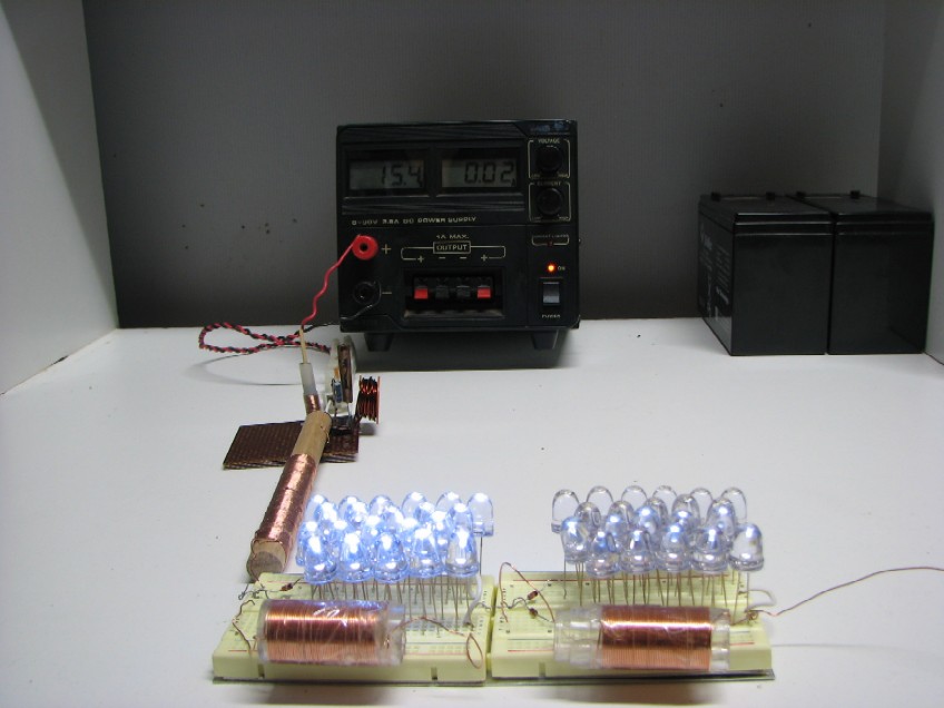

                I just hooked up my SEC 15-3 up to the towers similar to Lidmotor. All 48 LEDs lit easily and the transistor is remaining cool. I have a couple of radio tuning capacitors arriving this week. I would like to see if I can tune the towers through two different ground stakes in lieu of the single wire.
                • Two Receivers
                  Some interesting results tonight. I have the transmitter tower running off of a SEC 15-3. I have two receiver towers both simultaneously light LEDs well.
                  The first receiver tower has a one wire lead to the transmitter tower and I have a earth ground to the negative side of the AV plug that supports the LEDs. It lights the 48 LEDs so brightly that I can not look at them.
                  The second receiver is totally wireless. I only have 9 LEDs at this time lit. I will build a block of 48 tomorrow night. All nine of the LEDs shine brightly. On the second tower, I have the bottom lead of the tower going to earth ground and the end with the cups going to the AV plug for the 9 LEDs.
                  One very interesting part is that when I connected the earth ground to the 48 LEDs, the LEDs shined much brighter.

                          • Two Receivers
                            Well, less than the ideal results I was hoping for in running one transmitter with two receivers. All three tower were as close as I could get to being identical with the same number of windings and the length of the wire being the same. Each receiver had a bank of 48 bright white LEDs in series. I even went so far as to measure the resistance of the base of the coil to the cups and all three were very close. When I turned on the SEC 15-3, it lit both sets of LEDs to about 1/4 brightness. The transistor on the SEC remained at ambient temperature throughout the process. When I attempted to fine tune the SEC by turning the ferrite core, one set of LEDs would get brighter and the other set would dim. When I turned the core the opposite direction the situation on the LEDs sets would reverse. My interpretation of this is that the towers are still ever so slightly different in the tuning requirements that they are not in tune together. I had sort of suspected this. So, now I need to wait for my radio tuning capacitors... at least I think.
                            Doc, am I close on the logic process?
                            I am tired for tonight.

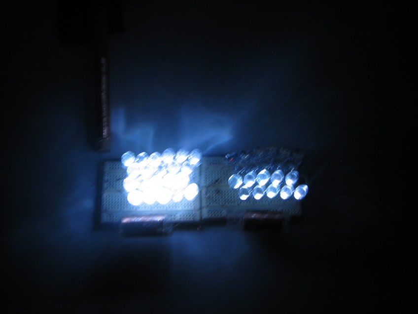

                                Hello everyone - have been enjoying your posts and links!
                                Here's some photos which you may find somewhat puzzling and worth considering.
                                When the inductance in emitter-base coil is reduced the AV Plug+LED array connected to the ground (on the right in photos) is all lit but the AV Plug+LED array between it and the Exciter is not.
                                What do you make of this?
