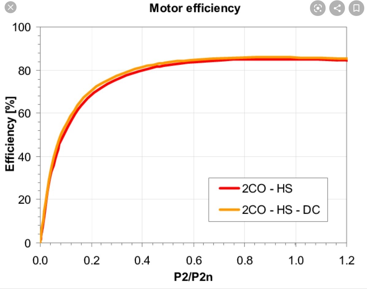

      • Turion,sorry to hear you're not sure about your skeptic tank! Part of our company installs sewage systems. For my own use I bought a secondhand bio disc from a local pub. It must be rated at about 100 arsepower, the disc is about 4ft diameter by 8ft long. Its driven via a huge reduction gearbox and a little motor. When I was motor testing I discovered to my horror how inefficient an induction motor is on a light load.

ID:	504308 Hi Lotec, the one post was describing my sewage treatment plant. It was an attempt on my part to add a bit of humour.
              The thing I wanted to point out was the importance of matching load and motor. See the chart.
              I think it's well worth watching video I put on post 1532, by cleverly considering back emf they managed to up the performance by two percent. I think a 96% efficiency for a relatively small motor is astonishing.

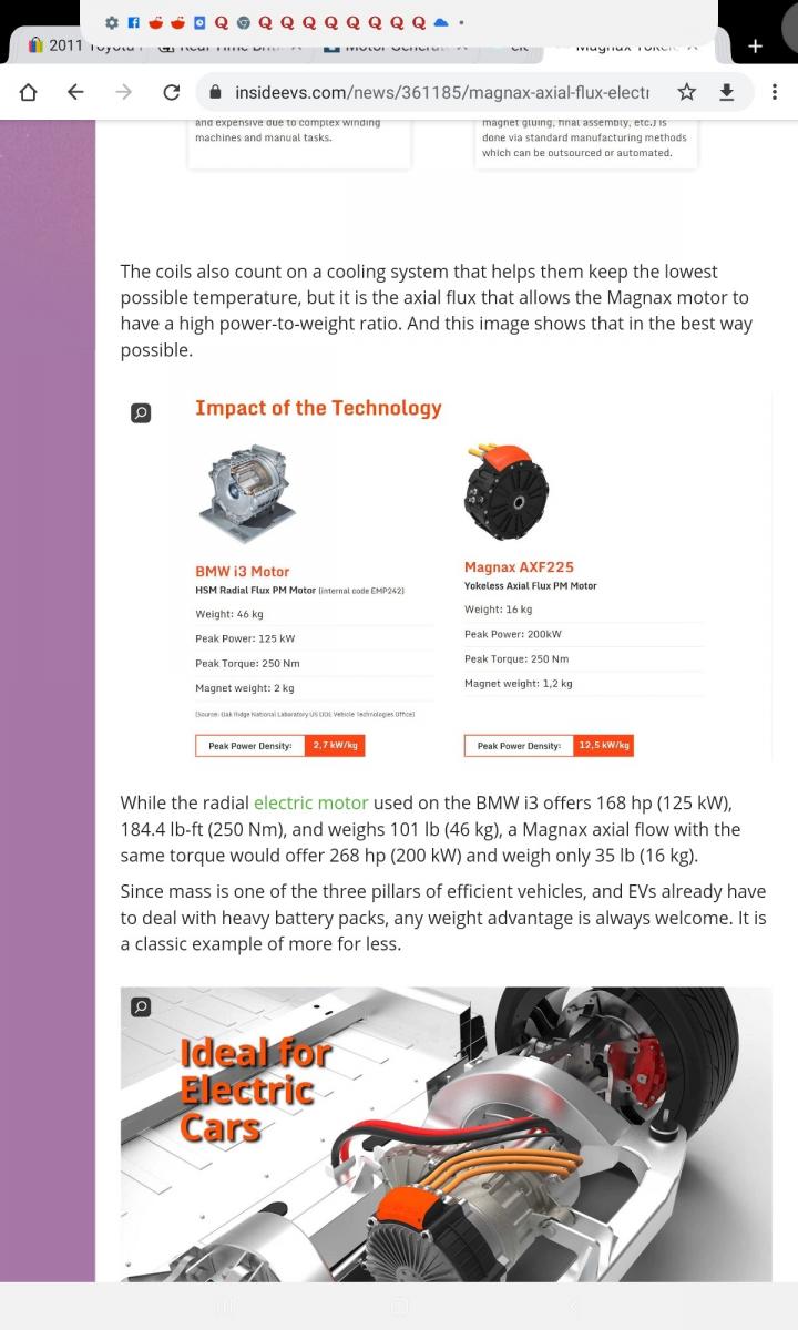

                            Interesting piece.
                            I came across this too. Obviously a case of horses for courses.
                            The yokeless, permanent-magnet topology offers greater efficiency around the motor’s central axis, and wastes very little copper on windings because the motors have zero overhang...
                            • I realise that this is probably manufacturers blurb, but if it's true it's quite impressive.
