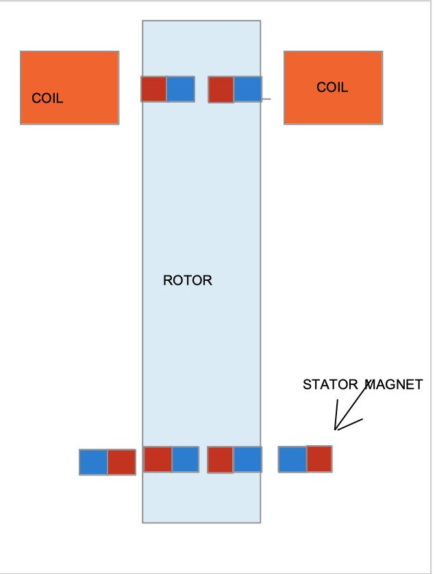

        Voltan,
        Same principle at work as in my generator, which I show below. It's what I have been saying for YEARS now. What you have shown is EXACTLY the 7th grade science experiment I asked bystander to do that he hasn't got around to yet. It proves what I have been saying is true. I just configured it differently after many small builds. But I started with EXACTLY the configuration you show. Then I moved to a motor coil as well as a generator coil so I didn't have a motor turning it. And finally I went to the configuration shown below, where the rotor is turned by a small motor and I have multiple coils and multiple sets of magnets on the stator. One set of magnets for each coil pair. An odd number of coils and an even number of magnets on the rotor. If you watch my videos I explain why. I already know it works, so have fun.

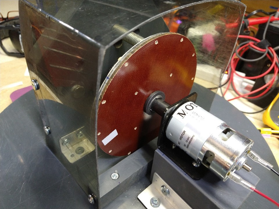

        Hi Turion,
        I've been working on my set-up. Had it functional to do the tests for a week or so. Got a Lexan scatter shield. Done 8kRPM. Just have 4 magnets on rotor so would like to do 15k. But thought I'd better get some data before going faster just in case. Ran some base data, no cores, one core, then two, then with the anticogging magnet and cores. I intend to plot the data.

            Hi Turion,

            • bi,
              Unless you have some "magic" machine, what you will see is this
              With no coils (and their cores) in place the motor draws the least current and has the greatest RPM for a set voltage input.
              As each coil (and its core) is added, it negatively impacts both the RPM and the amp draw, meaning the RPM goes DOWN and the amp draw goes UP.
              When magnetic neutralization is added, even with all the coils in place, you can return the motor to near its original RPM and original amp draw with the original voltage input.
              Please tell me I'm wrong. But, uhhhhhh, you can't.

                bi,
                You people who claim that the attraction of the rotor magnet FOREWARD to the core on approach is offset by the attraction of the rotor magnet BACKWARDS as it moves away are EQUAL and therefore there is "nothing to see here" need to consider that cogging itself PROVES there is a moment in time where the rotor magnet and coil are aligned which is not "offset " by ANYTHING or cogging would not exist. And it does NOT go away at speed. It is simply smoothed out the faster you go. But the attraction is ALWAYS there, and is what I call magnetic drag. The more coils you have the more amps the motor will draw due to this drag, UNLESS you "offset" it with magnetic repulsion. But you have fun playing with your setup now that you've actually BUILT something.
                th inch.
                Cogging is clearly evident when rotor magnets pass cores (attraction). Opposite (anti-cogging?) is evident when attempting to align a rotor magnet with the stator mounted magnet in opposition (repulsion) when steel cores are backed away. It is possible to set steel core(s) at minimum gap (.040") and adjust stator magnet to position where it neutralizes the attraction of magnets to core(s). However some cogging is still noticeable from the small PM motor.
                I've been able to collect data up to 8,000RPM. I've used both a wattmeter and an ammeter. The ammeter is more accurate but only good to 3A. To get a good range with the wattmeter I feel higher frequency is needed. To these ends, I've ordered additional magnets. I only had 5. Using all. I did make provisions for 12 on the rotor. That'll give me 3x frequency without going faster. I did run to 13,000RPM last night but don't like that. Vibration and commutation arcing are problem. I'd rather just wait a few days.
                I'll wait until I get more data and analyze it further before presenting it here. That shouldn't be long.

                        • Turion,
                          All I'm asking is this, except using cores instead of coils as you show in the diagram.
                          Voltan,
                          Click image for larger version Name:	ROTOR SETUP.png Views:	0 Size:	17.2 KB ID:	505075
                          Just run it at steady speed and back the stator magnets away showing effect on the motor current. You do it, and I'll do it. You go first. Afraid?
