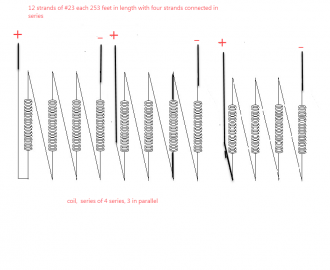

    • Bistander I think he's using four strands in series and then three coils in parallel.
      Using 22 magnets, new cores, 10 coils, going to 12 strands in parallel, realize that you're changing many design features all at once. Conventional wisdom would establish a known working benchmark and make one change at a time from there. But you ignore convention. So there will be lots of excuses for you to choose from.
      • Four strands in series and three WIRES in parallel from the SAME coil.
          ... Now that I know we are going to run the machine at around 3,000 RPM I can start looking for what capacitor gives us neutral coils with all 12 wires in parallel I want to see what voltage I get, and how many amps. ...
          • This is how I see twelve strands, four in series then in parallel.

            • I think the confusion is we are talking about two different things. Quantum was talking about how coils are wired NOW and his description was correct and his drawing is correct
              You were commenting on what I said about CHANGING that configuration to get lower voltage and higher amps and use a simple cap to get the capacitance that wiring in parallel and connecting in series provides and YOU are correct.

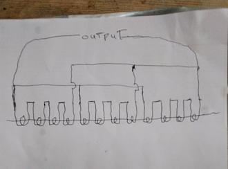

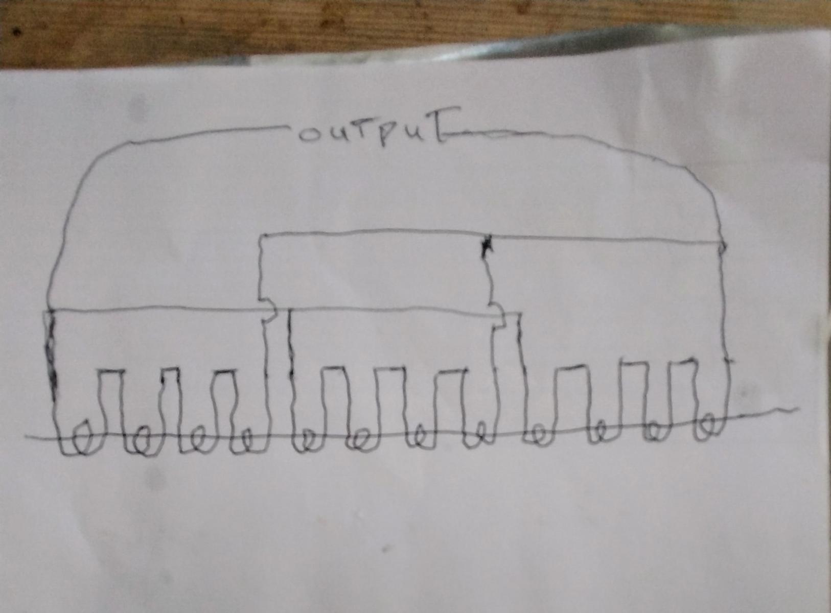

              • Here is the schematic
                It can be changed according to what you want
                This is the connection that gives you 130 volts, according to Mr. Dave's specifications.
                It already depends on what you want, voltage ?, amps ?, you can change the configuration.
                I remember that in one of the tests, I put it all in series, I had an oversight, my voltage whiplash.

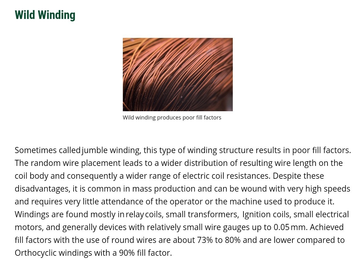

                      • Jumble.
