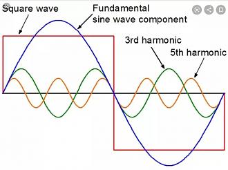

              Often wondered why light bulbs are so often used as loads. At least they don't make audible noise. But still annoying. A nice appropriately sized non-inductive resistor would be preferred.
              • Bystander, all we're interested in is efficiency? Input and output. A light bulb isn't much good, a precision resistor adequately cooled would be much better.
                Also see harmonics. Click image for larger version

                • You figure it out
