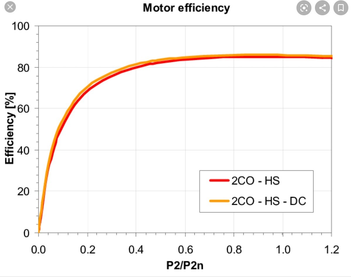

Turion,sorry to hear you're not sure about your skeptic tank! Part of our company installs sewage systems. For my own use I bought a secondhand bio disc from a local pub. It must be rated at about 100 arsepower, the disc is about 4ft diameter by 8ft long. Its driven via a huge reduction gearbox and a little motor. When I was motor testing I discovered to my horror how inefficient an induction motor is on a light load.

The thing I wanted to point out was the importance of matching load and motor. See the chart.

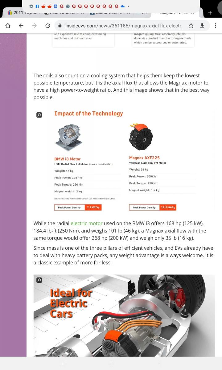

My intuition that GOES would be ideal for an axial flux generator is reinforced by this quote from Magnax.
The Magnax Axial Flux machines use ThyssenKrupp’s high-performance grain-oriented electrical steel (GOES) for its cores. Grain-oriented steel can’t be used with RF machines because the flux paths in these machines follow a nonlinear 2D path. In the Magnax AF topology, the grains of the steel are oriented in the same direction as the flux paths. Low losses and excellent permeability of the grain-oriented material in the rolling (axial) direction results in a machine with 85% reduced stator core losses and a slight increase of the electromagnetic torque.

The yokeless, permanent-magnet topology offers greater efficiency around the motor’s central axis, and wastes very little copper on windings because the motors have zero overhang...
